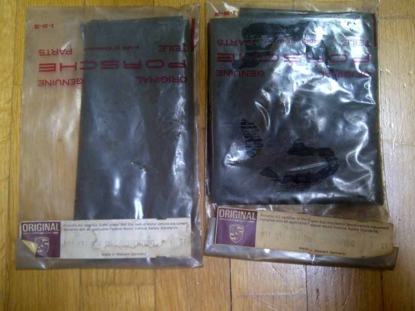

this time a found this little, unimportant bags... with a soooo rare code:
901 531 090 00 Abdichtung = Sealing film door inner panel Right . MY 69-

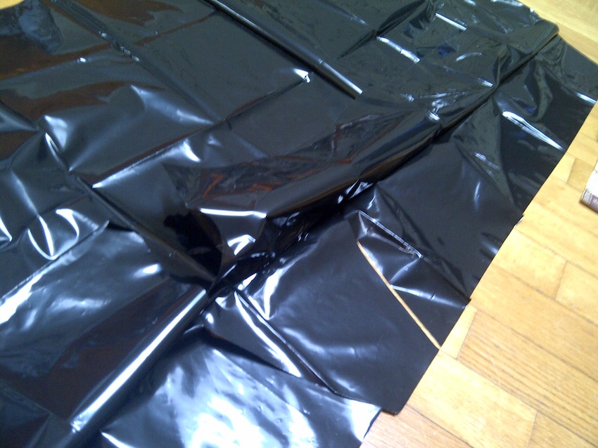

first. i found that the film is BLACK, not transparent as the modern types, and quite thick.

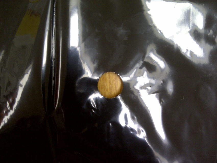

second: holes: only the hole for window regulator. no holes for electric windows switches.

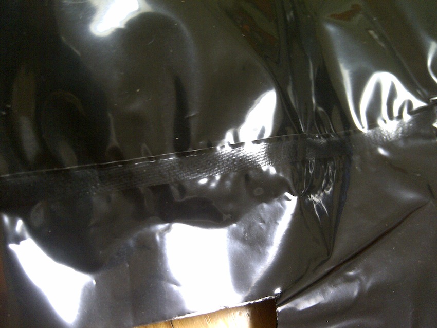

third, and this is the other big discover, it was not made only by 1 film, but in the bottom part there is a noter strip sealed togheter with the main film.
i've already did not understand why there are 2 parts sealed, but the important thing is that if you want to check a really unmolested car, you have another part to look at.
