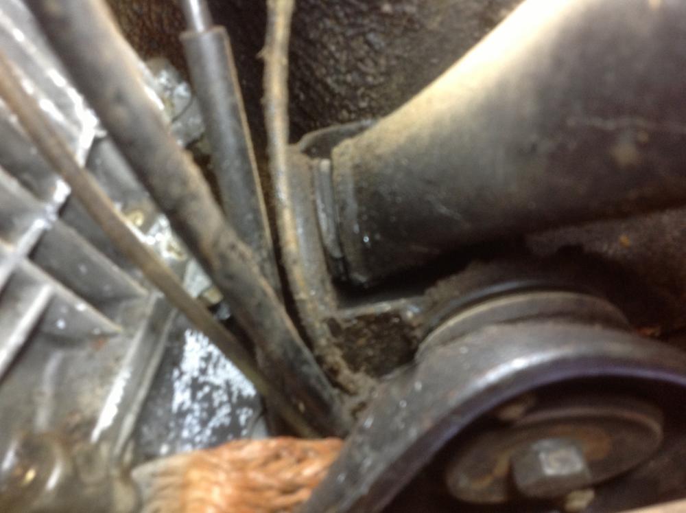

Hello All,
Went to the alignment shop with my '72 T and even though the car has only 36k miles on it they complained about the dried out bushings on the rear trailing arms and insisted on changing them out before a proper alignment can be done. They then proceeded to tell me that the job was a 9 hour job to the tune of $900 + alignment. I came home to investigate, and both here and on the Bird, people say that this job was the ugliest most trying job you can do on a 911. Bushings rarely fit even with mammoth levels of force, with some even resorting to freezing the bushings and heating the arms.
What have your experiences been on this subject? The bushings looked dry but not to the point of falling out. My car experiences a tail wagging phenomena at speed which I am sure should not be there. (I am sure bushings would help, but I don't lay all the blame at their feet)
Your thoughts are appreciated.
