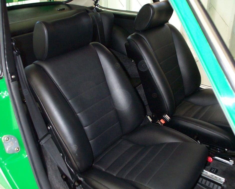

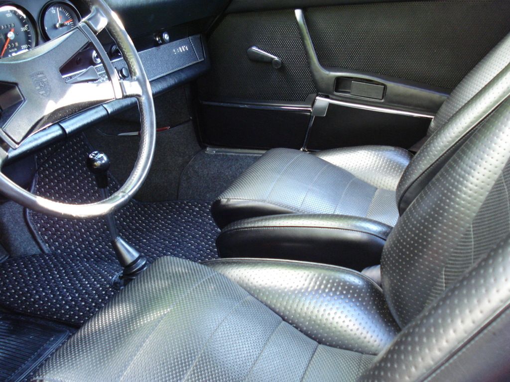

71 Sport seats had perforated bolsters (Leather or Vinyl)
72/73 Sport seats had blank surface on bolsters.
Some seat inserts in 73 available did not came in 71.
IMHO if you go for a 100% period look, 73 Recaro Sport Seats in a 71 can look "wrong".

71:
http://i1077.photobucket.com/albums/...1/DSC00523.jpg
72/73:
http://i1077.photobucket.com/albums/...ps0f7ec924.jpg
