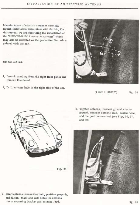

I looked at a 1967 in Florida last year being sold by the original owner who seemed to be pretty knowledgeable. That car had an electric antenna mounted on the right fender that he claimed was original.
Electric antennas were mounted on the right fender opposed to the manual ones mounted which were mounted on the left.
I have read this info in factory documents but my 30 year old mosh brain doesnŽt seem to recall exactly where..
(Also own a -66 912 with factory mounted electric antenna on rigth fender)
IŽll get back to you once iŽve sorted my brain mal functions...

The electric antenna is not listed in either the 66 or 67 Accessory broscures, but then again, there are lots of things on your list that aren't included in those broscures.
Jim
Here's another thread --- courtesy of Chuck Miller . . . see post #8 . . .
http://www.early911sregistry.org/for...ics-etc-please
HtH
PS Electric antenna = RH install

Regardless --- I would think the best way to confirm any options found on a car would be to look at the Kardex

Remember, too, that a lot of radios and antennae were installed in this country at dealerships, radio shops, and used-car dealers, where the mechanic could put the antenna wherever he liked.
