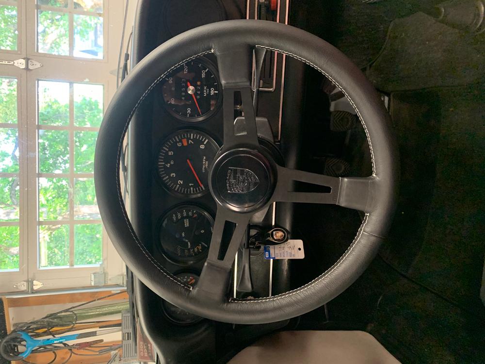

1. Swapped out the 350MM Momo Prototipo for the 911R wheel from Classicowheels. I have a 380mm 914 wheel in the Targa and like it (aka, the wheel for a true "RS clone"). My brother, with whom I share the RS clone at the track, prefers tiny wheels so I let him have a go with the prototipo. I personally found it awful - way too small and the hub brought the wheel too close to me (despite being rather large, I tend to sit pretty close to the dashboard). The small wheel made my steering too jabby and not smooth. The 911R wheel is perfect. Nice thick grip, good size (I think it is 365mm, you can find a much more exhaustive thread on it in the forum). Only asterisk is that it flexes a bit if you really push or pull on it hard, which is a little disconcerting, but was totally imperceptible on the track. Highly endorse this wheel - it seems to belong with the bigger tires on the car. In contrast to the targa with its 6" front wheels which seem to dance over the front of the road and one steers with their finger tips, the "race" suspension and big tires (toyo) make the RS feel a bit more dead on roads and requires muscle on the track. The thicker wheel goes with the more physical act of steering and is sublime at speed.
Attachment 558732

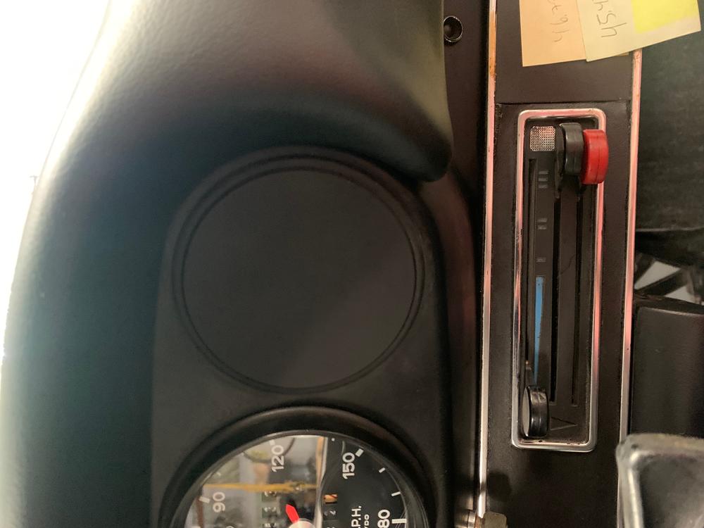

2. Clock delete, sourced from Jimmy, also available via search on the forum. Between the aluminum hood and the clock delete, I can tell the car is already .000000001 seconds faster.
Attachment 558733

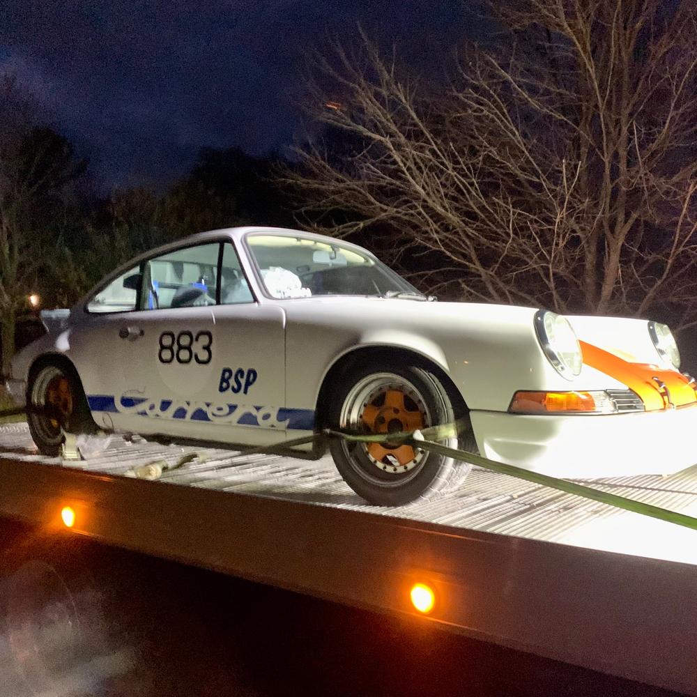

The clone, which my daughters have taken to calling Karen (which is hilarious), did a last DE in November and got sent off to Automobile Associates for a long winter of work. They are as accommodating of my stupidity as they are skilled.
It was dramatically sent off as this (where I believe the correct euro housings are shown):

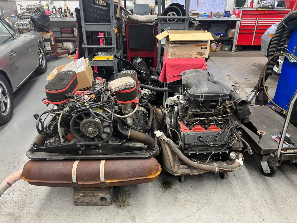

Before getting into the metal work, I've fully gone off the deep end on the M471 clone.
The first, truly insane dive was procuring a Euro MFI drive train, that is the 911/83 case, 019 MFI, and 915 with factory LSD. It arrived in surprisingly good condition, but is going to be completely taken apart and machined, shuffle-pinned, etc, so that it can handle DE work. The irony is I had already procured the 019 & S/RS TBs and Stacks which were done by Gus and Matt (Eurometrix), so I am now long an extra 2.7 MFI fuel delivery system. If anyone has a strong need, feel free to PM me (though I don't know that I'll have everything sorted for a few more months, and at that point I'll probably post one to the board for sale).
This is my 2.8 built by Reno Rennsport on the LHS (which is going in the targa because it has E Cams and is peppy at low RPMs, to say the least) next to the new to me 911/83 with the 019 MFI on top. Karen, the RS clone, will be using the 2.7 RS engine that was in my targa while the 911/83 has case work for the next year. It is a great engine from a 7R case that has been in the Automobile Associates/CVR PCA family for a long time.

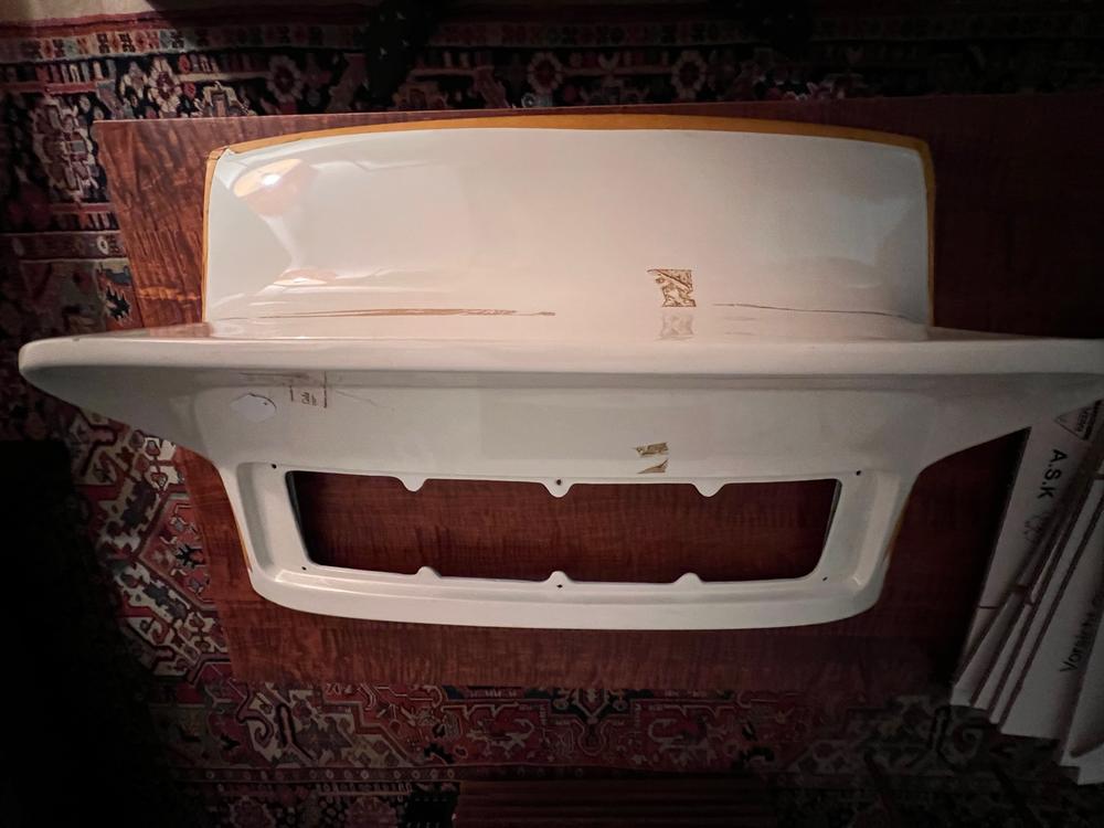

The second, mildly insane dive was finding an aluminum frame RS ducktail in Germany, thanks to Dirk. It just arrived this week after many months of badgering the seller. It is incredibly light, and so much more solid than the fiberglass repo that is currently on the car. Nothing beats having a RS ducktail on your coffee table. Like the engine, this will probably sit out the next year of HPDE and be installed on the car when it is nearing completion.
Attachment 568289
