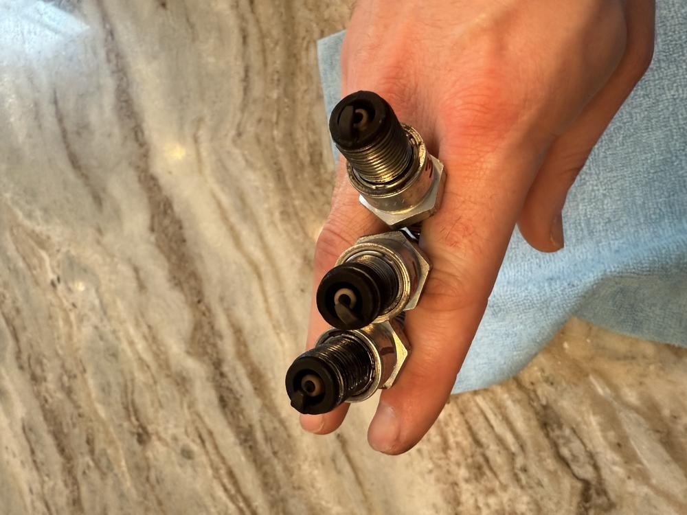

Just changed plugs from BR8EIX to BPR7EIX. The 8’s are pictured for any thoughts. Ceramic looks okay but ends are a little sooty. Thinking the hotter plug will be beneficial.
Attachment 636601
Attachment 636602
BPR6's would be fine in an E , the difference now will be using a BPR instead of a BR . The P's were noticeably better running in my S .
I plan on stopping by the shop tomorrow and will look at mine. My recollection is 7's for myself.
I run BPR7ES plugs (NGK part #5534) in my ‘69S MFI and am very happy with them.
