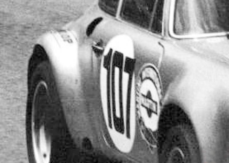

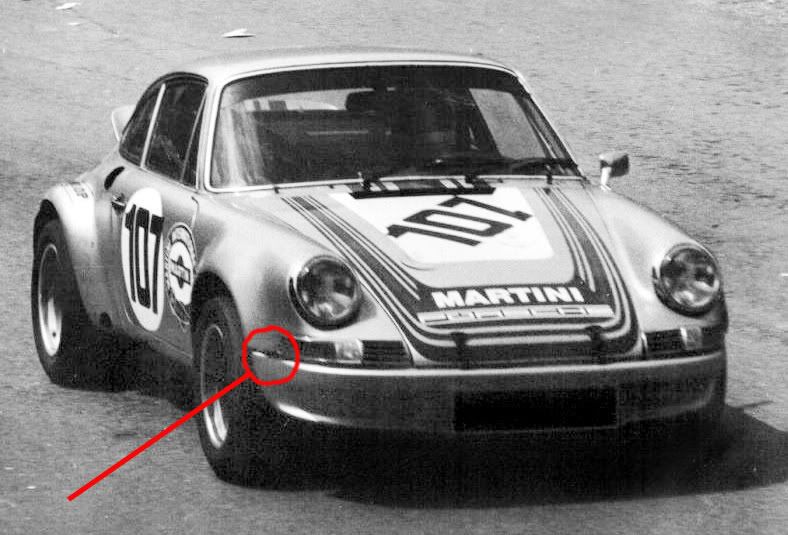

and one more............... as well as the 107 photo that i was trying (badly) to describe

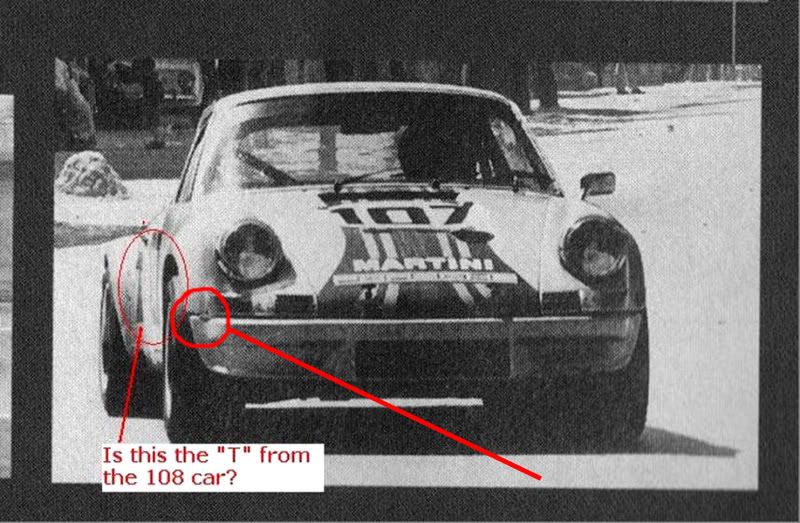

All I can contribute at this stage is that the headlights worked perfectly on race car #8 ;) .
I have this picture which I believe is of one of the Martini Racing cars at the Targa - see the primitive Mary Stuart similar or identical as done at the Targa on the other cars, and dirt on the tyres.
It is NOT race number 8 - that car had SHELL decals on the rear guards - see next pic
It is not race #107 as it has the unique Martini Racing decal on the rear guard as also seen in the wind tunnel shots and besides 107 did not have the Mary Stuart tail. See picture in the race with "martini racing" just visible
It is almost certain not the original 107 (thought to be R8 from Monza) as the Mary Stuart tails seemed to have been added after practice (from the video evidence) and the original 107 was crashed and ceased to participate further before that happened. However that still is a possibility.
It is NOT the car that was # 9 in the race as it was in the race as it had a SHELL decal on the rear bumper and completely different livery on the engine lid although it may have had Bilstein and Dunlop on the rear guard, and the martini stripe going up to the roof is similar (but to my mind NOT IDENTICAL) to this photo.
The #9 photos I have are too indistinct (or my eyes are not good enough) to tell what the decals on the rear guards are on the race #9.
However I would like to suggest that this may be car #9 at some stage in practice - before it had its reported accident.
Mary Stuart tails were only allowed on Sports class cars (not on GT class). The race photos of car 9 show apparent damage (roughly repaired) to the RHR guard - making it look somewhat like one of the pics of the LEO- ZA cars from Paul Ricard. They also show a probable non original engine lid (it looks almost like it has been taken off a road car - there is no martini livery), and the rear bumpers have 3 slots for the exhaust and there is no colour on the license plate panel that is completely inconsistent with the treatment on car 8.(and the Martini cars at other events)
Maybe the picture I have posted IS car #9 before the accident that Pucci is supposed to have had in it (I know another topic as to whether it was Pucci and why would he be in that car anyway:) ) . The accident could have been putting the back / back RHS into something hard, necessitating a new rear bumper, engine lid and RHR guard repair??
The other possibility is that it is AN ENTIRELY DIFFERENT car #9 and the car #9 in the race was a second "ring in". I don't think that , so far, there is enough evidence to seriously suggest this and what evidence there is suggests that the car was damaged and repaired.
Any comments / other suggestions ? and does anyone have any background on this top photo?

I have to say , that if asked whether 107 or 9 looks most like a car that had been wacked against a tree and was still being fixed with crowbars - especially in the rear - on race morning, I would say that 9 looks more likely than 107 based on the pictures we have here. And that would be consistent with factory records that 020 was race car 9 and that Pucci had bent it. But why would Pucci have been in 9 to start with? Maybe because Haldi was never going to be in it until the last minute??
Is it plausible to argue:
- R8 was originally entered in GT as 107 and practiced but was totalled by someone (unknown at this stage)
- 020 was originally entered as car 9 with Pucci in Sport was damaged in practice by Pucci but still raced
- 002, the press car, which was down there as a T car (aka Mongrel or E42), was drafted as a second 107 with R8's engine and front bonnet amongst other parts
- Pucci bent 020 but it was fixed in time for the race however by that time he had been put to car 107 with Haldi being drafted for car 9

I know John Starkey ha a different view but I am struggling to see how they could be the same car.
I think the car in the ONS photo IS the 107 car at the Targa and it IS RS 002, ex a 72 ST, ex the Strahle car, and while it is pictured on the ONS pass as 020 R2, I believe it is a different car to 020.
However I dont know why the ONS document would show a picture of a different car, unless it was a representative photo only. I had thought, until now, that the ONS document is like the FIA document today that shows the actual car - but maybe not.
Perhaps someone out there can clear this up.
I think 020 was built in Oct 72, did the TdC as car #2 in November (it had black horn grills light surrounds etc and "normal" looking rear guards) then MAYBE/PROBABLY the Paul Ricard test, then the Le Mans test and 4 hour as car #62, then WENT TO the Targa as car 9 and then did Le Mans as car 48 before being the museum car
HOWEVER I am still not sure whether or not the car pictured on this thread as car 9 at the targa IS 020.
This is because, apart from this ONS document which I think is NOT 020, I have not seen any other evidence of an oil door on 020 (except in the Targa shots) and the other pictures of cars that are supposed to be 020 do not seem to have oil doors.
Granted some of the pictures do not show the oil door area well, and it would be good to get close ups of TdC car 2, the Le Mans test car, and car 9 at the targa in practice to make sure.
However i have been looking for these for a long time now and fear that they do not exist, in the public arena at least.
I think 002 and 020 R2 are 2 separate cars, and they ran as 107 and 9 respectively at the Targa. Even though no oil door is visible in the TdC pictures of the red/white rally version of 020 R2, the shots of this car at Paul Ricard with tacked on flares is the very best evidence that this car is #9 at the TF, plus the red top and no other Martini sponsorship evidence. I don't think there is another RSR proto that had the tacked flares, and these are very easily spotted in photos.
Besides, there is just no other explanation that makes sense for the indisputable pics of 9 and 107 in the TF. There appears to be too much factory documentation that supports that both cars existed, including Singer's notes. The ONS document (Wagenpass) is clearly the press car, which means it is 002 not 020 R2, so the document data and picture are not consistant. As Hugh suggests, there is probably a good explanation for this, so we should not get too disjointed over it.

I think we have (virtually) resolved that car 107 at the Targa was a 1972 shell and was a last minute stand-in for the car that crashed beyond repair; probably R8.
I think it is also (almost) agreed that this car is RS 002, which is the press car and before that the ex Strahle ST (and by the looks of it the car pictured on the ONS pass for R2 RS 020 with #3 on it).
I have just discovered a set of decals for a model of #107 that look remarkably accurate, down to the two colored "martini racing" decals that are`hard to see on black and white pictures of the press car.
Included in the decal set is a number plate - LEO ZA 68. This is the plate on the Waldegaard Tour de Corse car from November 1972:eek: and ties this and the TdC thread http://www.early911sregistry.org/for...ad.php?t=16839 together.
I can almost make out a number plate on the back of the 107 car in the picture of it attached. The magnification needed kills the detail but I can just see "ZA". I have no reason to believe the decal is wrong - but would love to know the source of the information used to create the decals.
That raises two possibilities:
Firstly the Waldegaard "68" car at the TdC was RS002, and after its accident there it was repaired and repainted in Martini colors to be launched as the press car, and eventually used as the 107 car at the Targa (instead of the "history" in the RS book amongst other places of it being used on the "panzer " test track. This means there is a possibility of it still existing now. or;
Secondly the Waldegaard car at the TdC was another ex ST, and did get used on the "panzer track" and eventually as a recce car for a safari rallye (and probably perished there) and the factory transferred the plates to RS 002 when it was launched as the press car.
I would like to believe the first scenario which, if correct, would suggest that BOTH of the ex TdC RS / RSR's competed in the Targa as the other TdC car (Larrousse's LEO ZA 69) is supposed to be RS020 R2 which ,in turn, is supposed to be car #9 at the Targa.
Hugh:
Interesting find on the Mini Champs decals with the LEO ZA 68 plate. I have the model, and am posting a picture. Your hypothesis muddies the water with the 107 car...but I do agree that there does appear to be a LEO ZA plate on the 107 car at the Targa in that cornering shot. I tried to see it in the video, but can't quite make it out, but there is some kind of plate visible.
Regardless of this plate, I think the 107 car is very consistant in photos from the red Strahle version in July 72 to the Targa. Turn lenses have silver trim (both LEO ZA cars have black), and the rear flares are very distinctive...and that little mud flap on the rear of the wheel opening is there all the way through this period. The LEO ZA rear flares look different on both cars, and I doubt that the original Strahle flares would have been re-attached and lenses changed back to silver after the TdC efforts.
I don't have any good explanation why the LEO ZA plate would be on 107, but there must be one. Maybe the answer is that the bumper was replaced (but not that mud flap) for some reason with an old spare from the LEO ZA car that wrecked with the plate still attached.

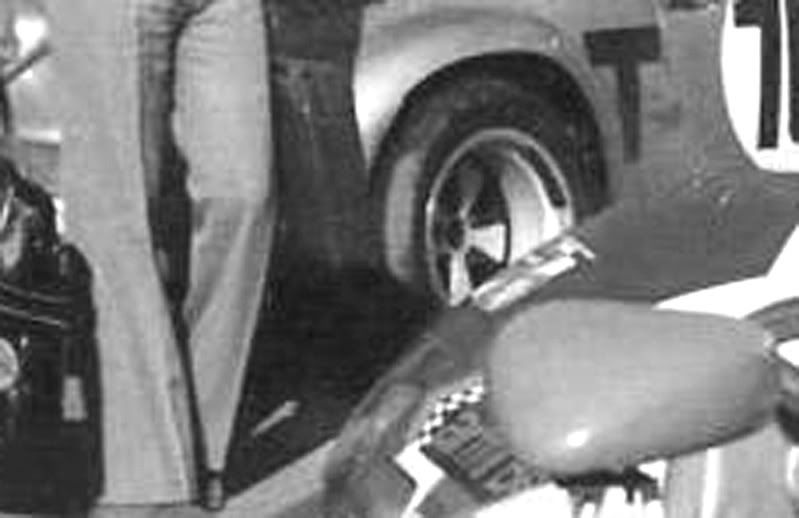

Totally different shapes on the 'Mary Stuart' tail extensions .... are they different because they were quickly handcut and tacked on? Or were they purposely trying different shapes?
Curt
I think the shapes are different because "they were quickly handcut and tacked on" as they had proper filled in (by the look of it fibre glass) at Spa and Monza before the targa. They were obviously experimenting with the shape from Dec 1972 on at Paul Ricard etc and by April seem to have about the final shape determined.
