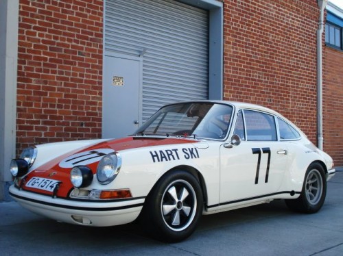

and the rear flares actually allowed on FIA events, together with the stock ones, are those on this very well known car:
Attachment 203480
... which, in my humble opinion, don't really look like yours...
Maybe yours were custom made by some skilled guy at that time... ???
