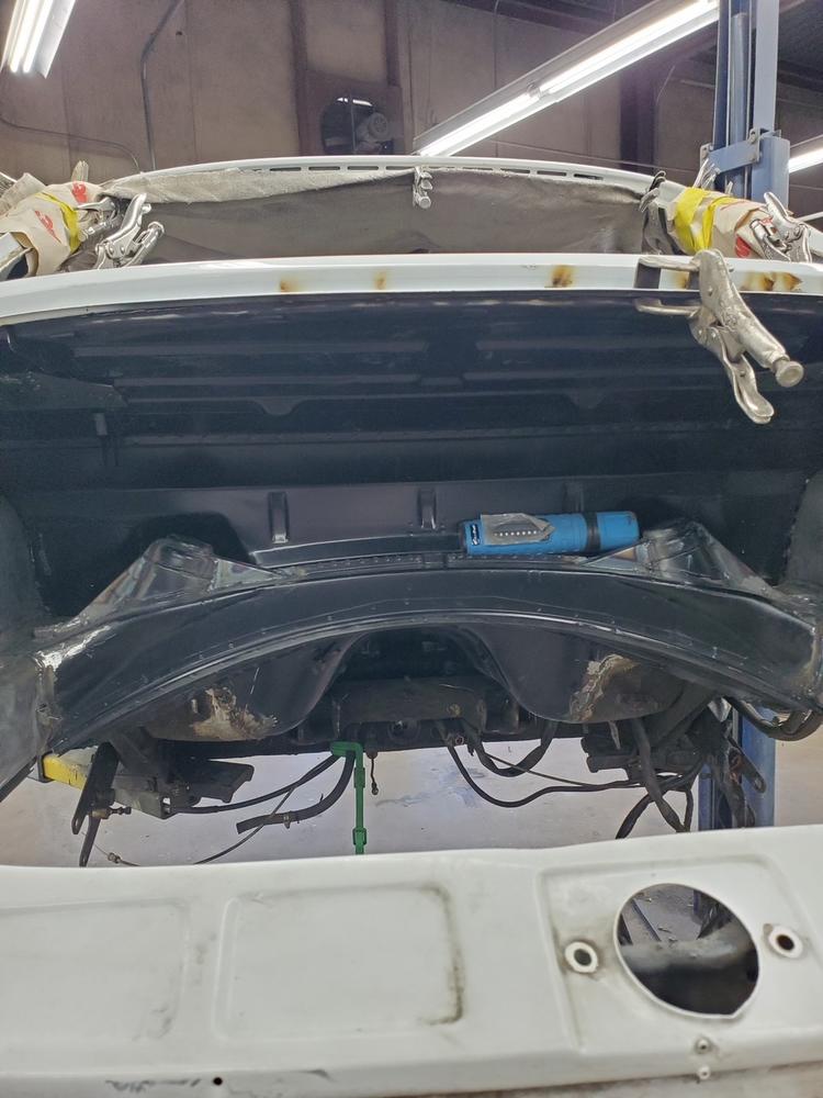

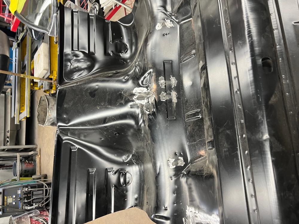

Here is the first area to be attacked - the 915 requires a bigger tunnel, so this will get chopped out.
Attachment 568294
The tunnel replaced with this from an old race car donor shell that is on hand. Note how much wider/larger the 915 tunnel is.
Attachment 568295

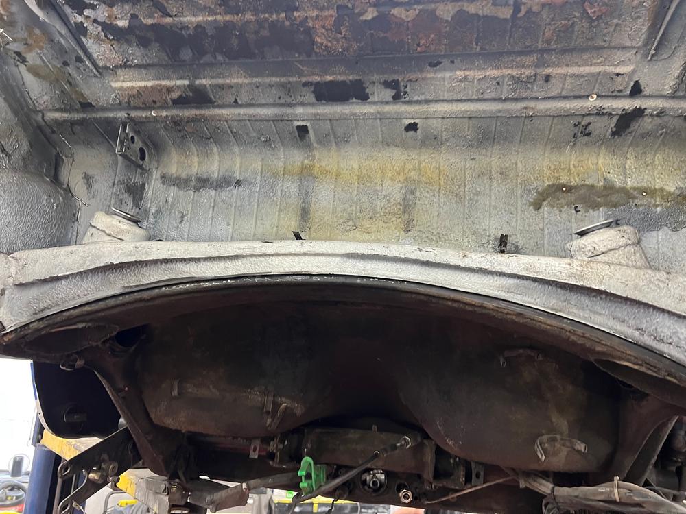

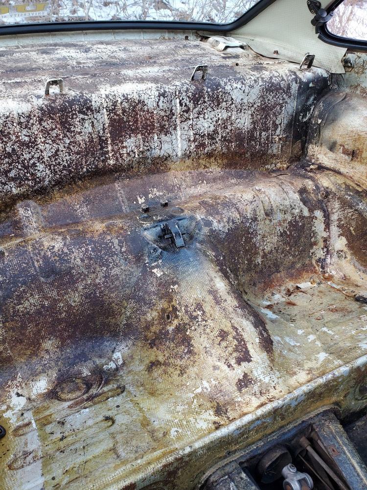

Sadly, the totality of the car was not rust free. The car must of had some water intrusion from a bad seal on the rear windshield, so a little bit of the parcel shelf by the rear window will need to go. Also note that the hole for the oil tank is a bit of a hack-job as they fit a later Carrera tank when the car was converted to a track car about 14 years ago. That too will be repaired.

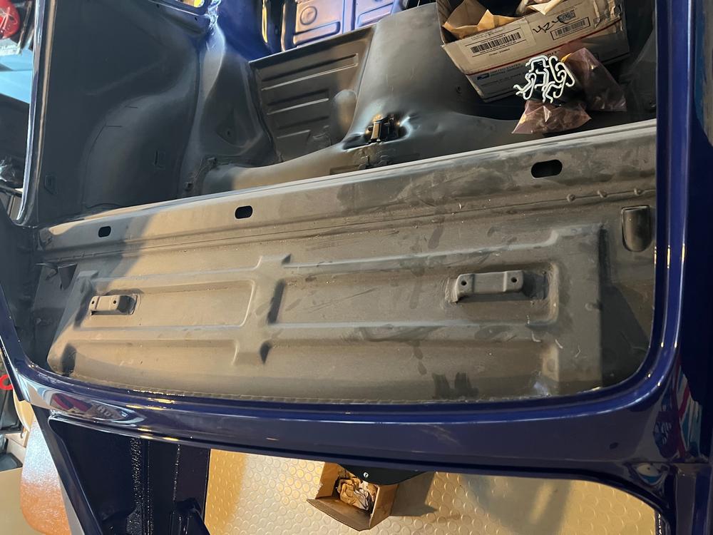

The good news is if you are an anal RS clone builder, then the rear parcel shelf needs to go anyway! One of the great fortunes of having a shop like Automobile Associates do this work is that they often have reference material handy. This is in their reception lobby...
Attachment 568299
Hard to describe exactly, but the parcel shelf of a '73 is flatter and different to that of a '71, so it will be replaced too. You might also note the harness anchor points in the original above. Fortunately, from New Zealand, I have some replicas, which I am told are much easier to install when the metal is outside of the car.

And the last bit, back to the original...the rear shock towers of a '73 are much beefier than a '71.
The originals from the '71 that will be replaced...
Attachment 568301
relative to the "correct" ones on the reference body.
Attachment 568302
The shock towers will also get the ST/RSR reinforcements, which is a bit of a migration, but looks cool and in theory stiffens things up in a period-correct way. In any case, tons of minute detail to get a proper "clone" done, and none of it will be visible!

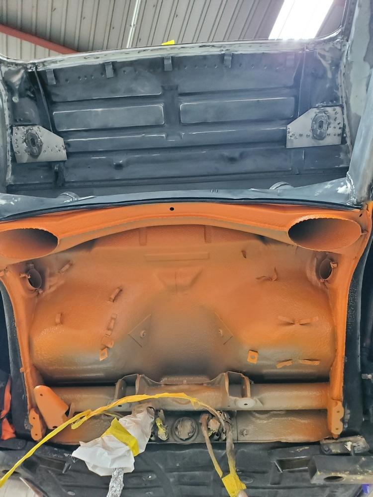

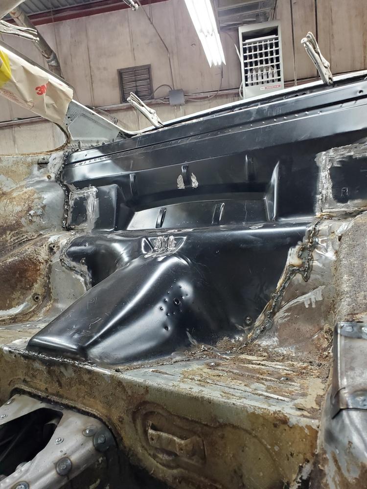

More updates...never in my life would I have imagined myself to be so excited about sheet metal and the painting of an engine bay. First up, some photos of the welded-in rear shelf, shock towers, and transmission tunnel. This is all a bit absurd, but then if you want a RS clone, you can't just slap a ducktail on it and pretend you're driving a race car for the road, can you?
First up is the rear panel, where there are two keys in transforming a '71 E into a '73 RS body. The tunnel reinforcement and the larger "hump" to fit the 915 transmission.
Attachment 570051
And then from the rear, the flatter shelf, beefier shock towers, and most importantly, the shock tower reinforcement.
Attachment 570052

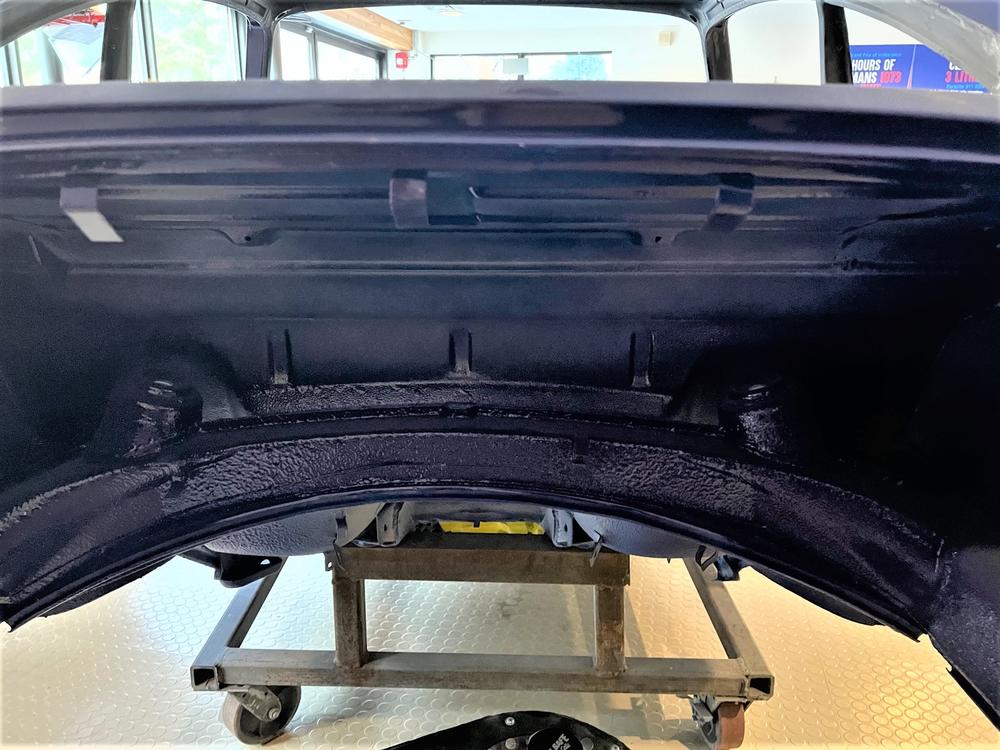

And with that all done, the painting. Black first on the underbody...
Attachment 570053
And then some Gulf Orange over the top. Note the shock towers and the harness mounts welded from below...
Attachment 570054
And then, as is appropriate for the '72 on cars, the engine bay painted the body color, with those shock tower reinforcements looking particularly sexy in the fresh paint.
Attachment 570055
And yes, in case not clear, the exterior of the car is staying white, so Automobile Associates did a cursory respray of the fridge white on the slam panel, etc, because the original conversion to race car white had some flaking and surface rust. I was joking to them that for the next year my engine bay is going to be a little treasure chest. The car will still have its dodgy off-fridge white exterior customary of a track car, and have an immaculate engine bay before the totality of the exterior is redone next year. All credit to them for accommodating my desire to drive the car while undertaking a fairly faithful build of a RS clone. Cross fingers that it all works ok in coming months.
