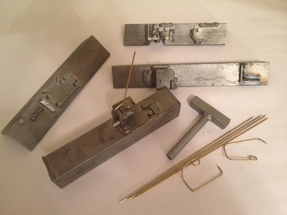

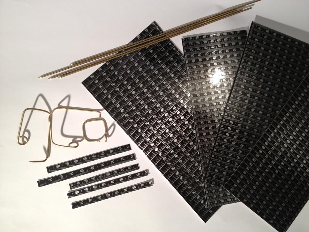

Here are the scales used on the 5 protractors with the first test bends of the brass pointers. I have made jigs for bending these. ETA on the protractors is the end of January.

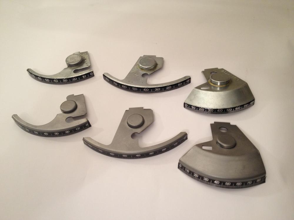

Nearing completion now.... ETA end of this month if the cases come in on time.
The ones in the foreground are the new ones.... whilst the ones at the back are the Porsche originals. I have lightly bead blasted the finish on the prototype set to clean up the welding marks but the finished sets are going to be Zinc plated giving them a bright finish like the originals.
You can see that the holders for the Neodymium magnets are smaller than the originals. I had wanted them to be the same diameter and depth, but they proved to be too strong at that size. Seriously, the early prototype set I made was bending tying to pull them off and the magnets kept pulling out of the holders.
The laser etching of the numbers is still too faint so I have asked for this to be cut deeper. This will include my website address 911mfi.com as I don’t want any risk of these being passed off as originals.
I have asked for the scale flange on the pump protractor P228 604 to be cut back to match the originals as its too deep on this prototype.

I have also posted a photo of the pointer bending jigs, as they are quote interesting. They look rather Heath Robinson but are remarkably effective.
Attachment 235963Attachment 235968
