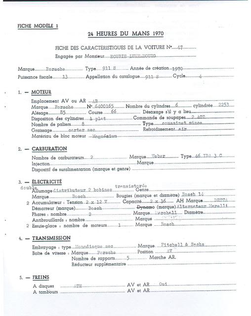

I have been doing some research for a future project and have landed on the #47 Kremer that ran at Le Mans in 1970. I have drifted into the weeds on this, so pardon the “RainMan” moment. I need to pick your brains on a detail to two.
Attachment 263810
I’ve borrowed some photos from earlier in this 911 ST thread, and have some questions on the 2.3L (911/22 (2247cc) in Type Index "FSP"), carbureted engine; the proper manifolds and velocity stacks.
Attachment 263807
Attachment 263808
Attachment 263809
The early “For Sports Purpose” & notes the correct manifolds for the 911R & 914-6 GT (pg., 1/7, March ’70).
901.108.045.00 (Intake Manifold Right)
901.108.046.00 (Intake Manifold Left)
Would these be the same as used on the ’70 #47 Kremer? What was their composition Al or Mg? and does anyone have pictures sans the 46IDA’s?

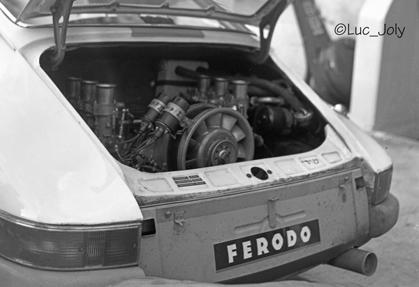

The next question, the Velocity stacks of a similar carbureted car, appear to be taller that the standard 46IDA (~56mm or 2 & 3/16”). Can someone ID the type or part? or have I been staring into the sun for too long? Any help would be greatly appreciated.
Attachment 263811
