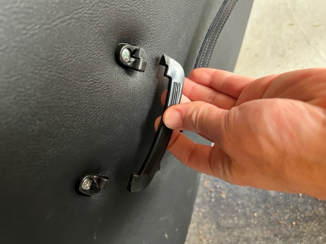

Just stupid me leaning over to open and close the door which may or may not have been rattling as I was rolling down my driveway. The plastic repros are fine, and I promptly ordered a replacement, but I also looked for an alternative...sadly the Ti porsche parts guy on pelican's replicas are too large for the correct mountings on our doors, so those don't work. But these looked promising...
Attachment 576216
Unfortunately, they are from the UK, and the price isn't as nice as the plastic ones...but I paid the porsche tax and bought for inspection. In person, they look reasonably nice and are a good alternative. However, there is one glaring difference. The RS pulls are black and these are chrome! So...I asked my shop to send them off to be stripped of chrome and painted/anodized matt black. So I'll let you decide.
The originals today.
Attachment 576217
And the metal replacements today.
Attachment 576218
Might not be good enough for a Karen, but Karen will be fine with them for the time being. If anyone wants to make these, or make these better...might be a good product to sell. No chance anyone looking into the car knows the difference. And they are infinitely more durable than the originals. All about the details in this car...and yes, almost all of the details above are wrong, but the main purpose of Karen for now is a DE car and in time the details will be sorted.

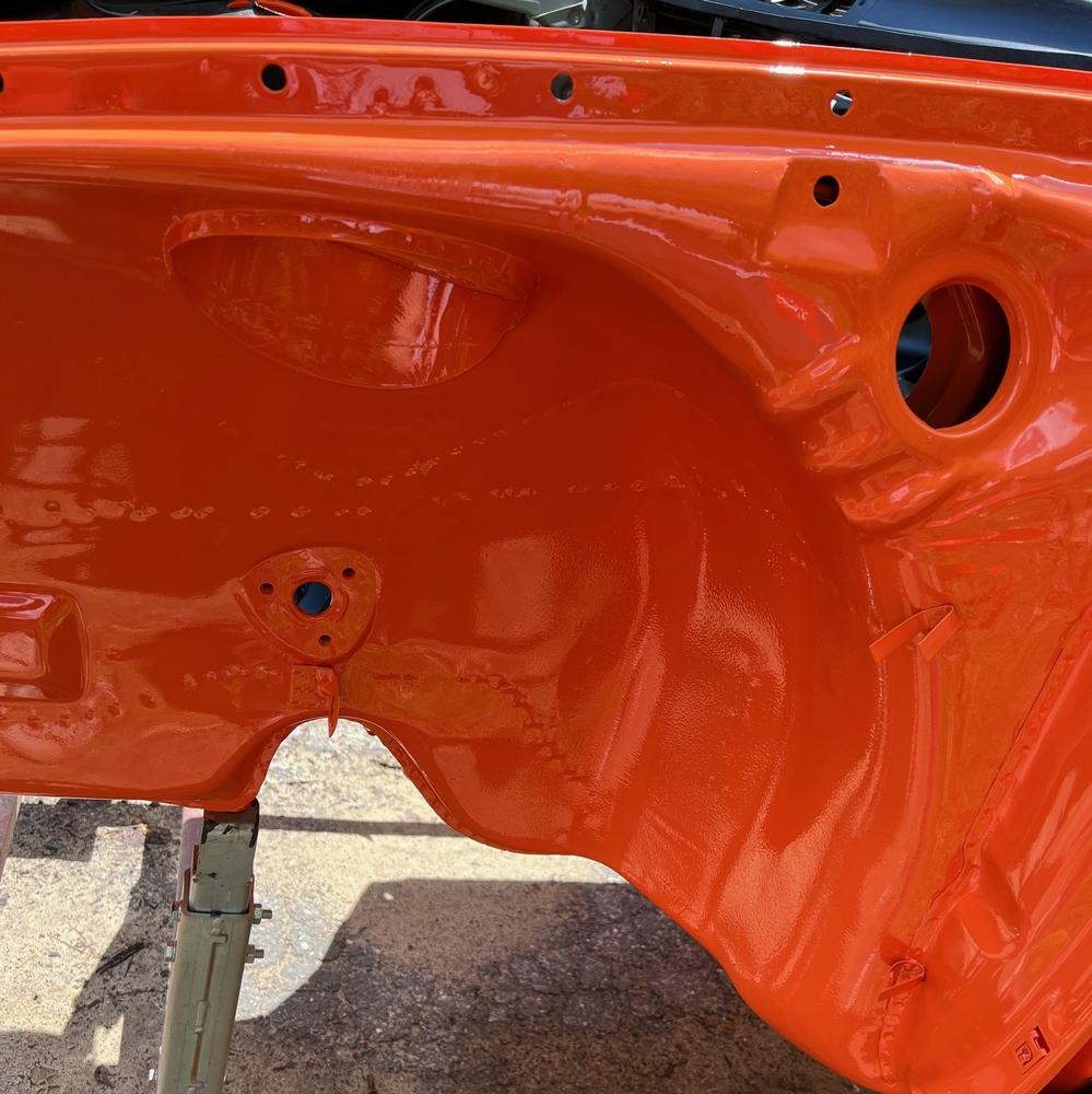

Well...turns out a rust-free car is not a work-free car and the front needed a ton of work because a prior shunt was inadequately repaired, and prior front clip replacement due to battery acid was...inadequately repaired. I suppose that is a lesson for buyers of these cars - though admittedly this car would have been fine for street driving as it was and the "needed" repairs are really about getting everything perfect and having a car that is 100% capable in the future. Just because a car is rust free doesn't mean it won't need work...they all need work!
Needless to say, the results of the redone front-trunk area are exceptional. It will look perfect once sprayed gulf orange and the rally tank is dropped in.

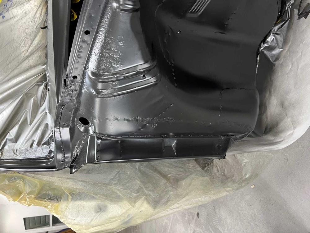

The real reason I decided to post was to see if anyone can explain what was replaced in the below photo, and why the sheet metal is now consistent with a '72/'73 car rather than the '71 that I started with. Apologies for the bad orientation, I am a tech savvy person and I can't figure out why this website flips images randomly.
Attachment 594532
In any case, such are the "repairs" to a car when you are making a true clone - from having a 911/83 case and 019 pump to having all of the sheet metal look correct just in case someone peers up into the passenger wheel well.
The 71 had the front cooler lines bulges in the joining panel. 72 didn't because the lines ran under the rocker panel.

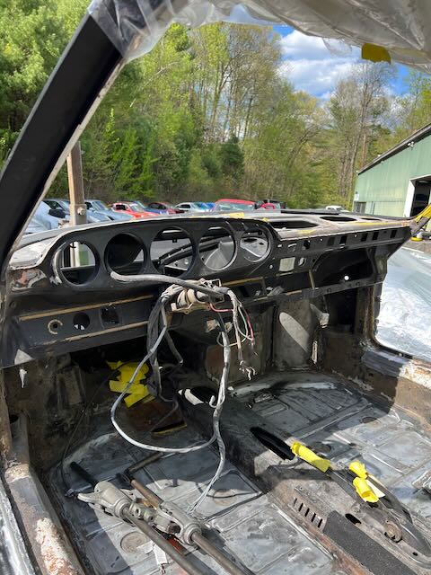

Distraction aside, keeping with the theme of details mattering, have a look at this photo to see the change made to make a '71 frame into a '73:
Attachment 618881
A close-up makes it more apparent.
Attachment 618882
The '71 and earlier cars had the lighter in the middle of the three dash holes. In '73, the lighter was moved to the rightmost position. Other than an excessive willingness to pay to get trivial details correct, I will be proud to say that this sort of attention to detail is what separates a "clone" from a "tribute."

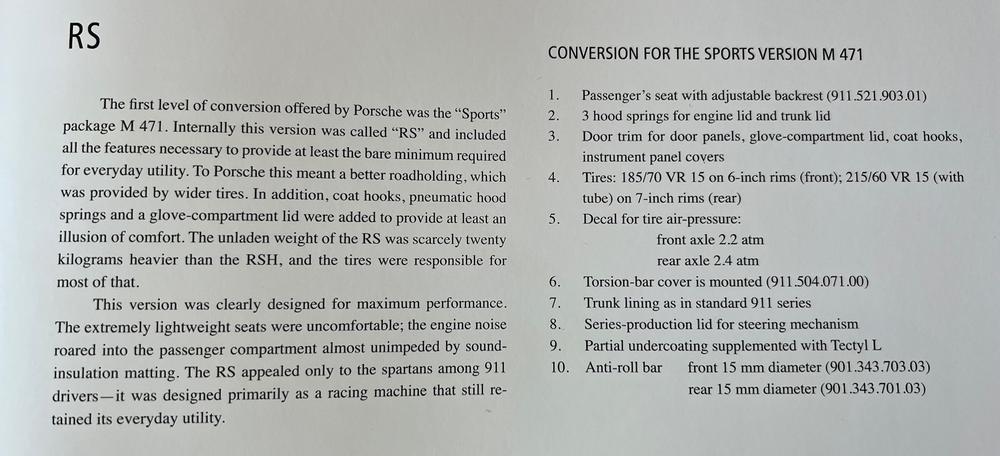

Then, if we flip forward a few pages to the conversion from RSH to M471, we see ten items that civilized the car somewhat (or more appropriately, helped form the basis for Porsche's first "production" race car for the road):
Attachment 619005
And again, for the purposes of this post, the item of interest is number nine - "partial undercoating supplemented with Tectyl L." While this is minorly helpful - the cars didn't have much undercoating and only in very specific areas - you don't exactly have a great sense of what was done in the wheel wells. Once again, expertise is critical insofar as you can get someone who has seen and restored the real cars. It turns out the undercoating is ~12-14 inch strip on the same axis as the wheel (if that makes sense) on the wheel wells. You can see it here:

Or perhaps not. I certainly didn't see it at first. Instead, my eye went to the spot welds and the candy-like surface of the inner wheel well
The close up helps illustrate the rougher surface of the undercoating. Hopefully looking at the above photo in the context of the below photo helps to illustrate where there is, and is not, undercoating. It is also an illustration of why the execution of the metal work on a RSH/M471 is so important - the lack of undercoating makes everything so much more visible on this car compared to a normal '73 911 or even the touring iteration of the RS.
