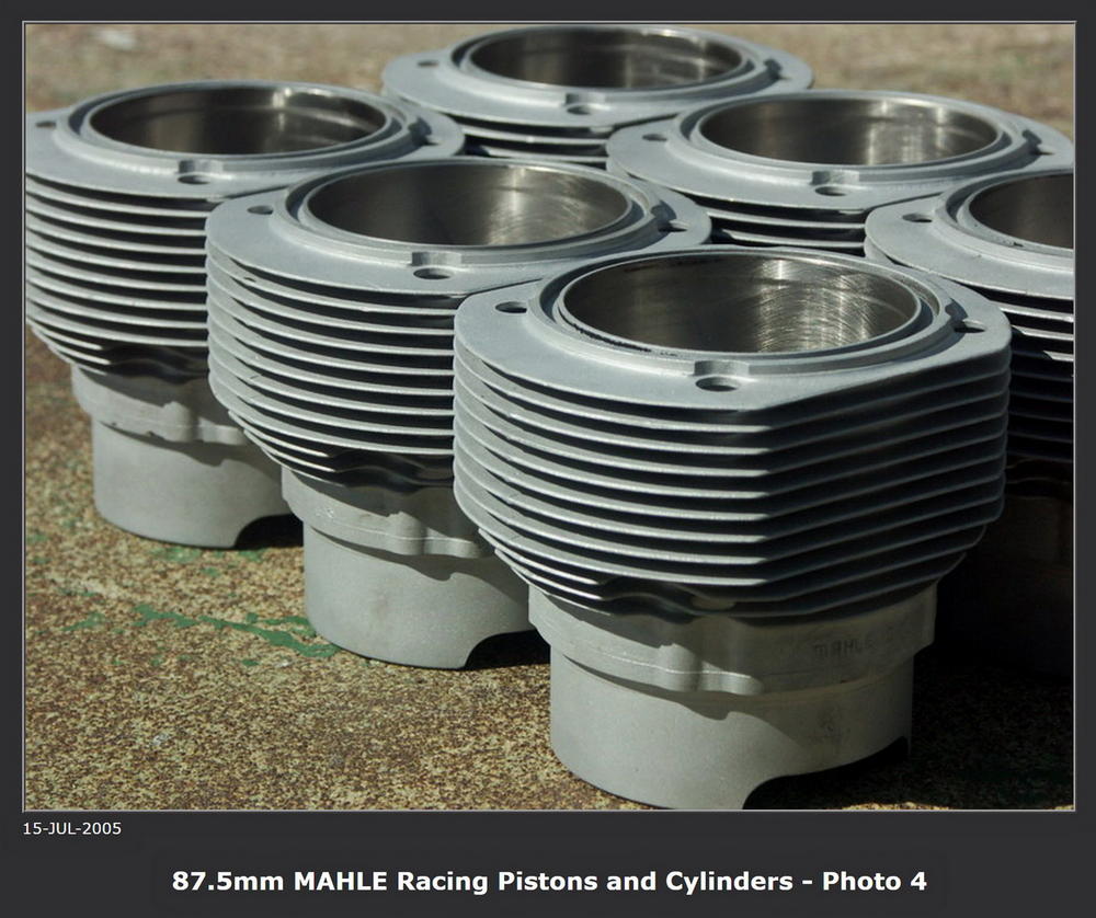

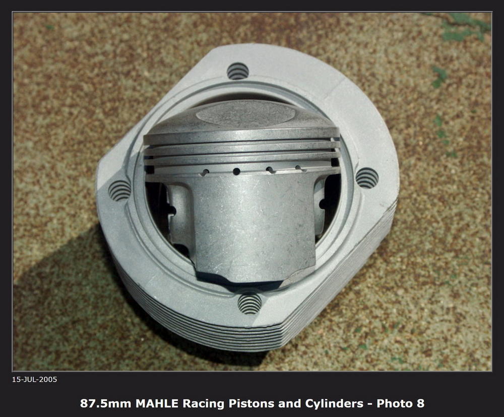

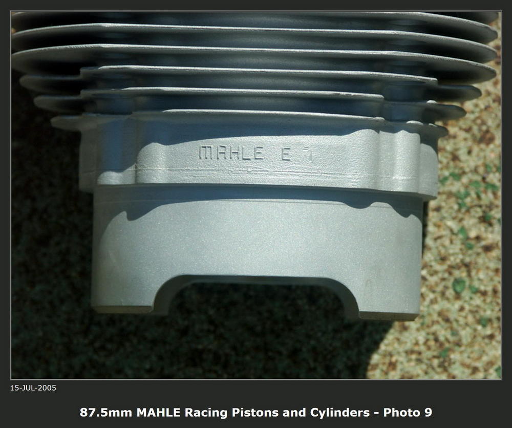

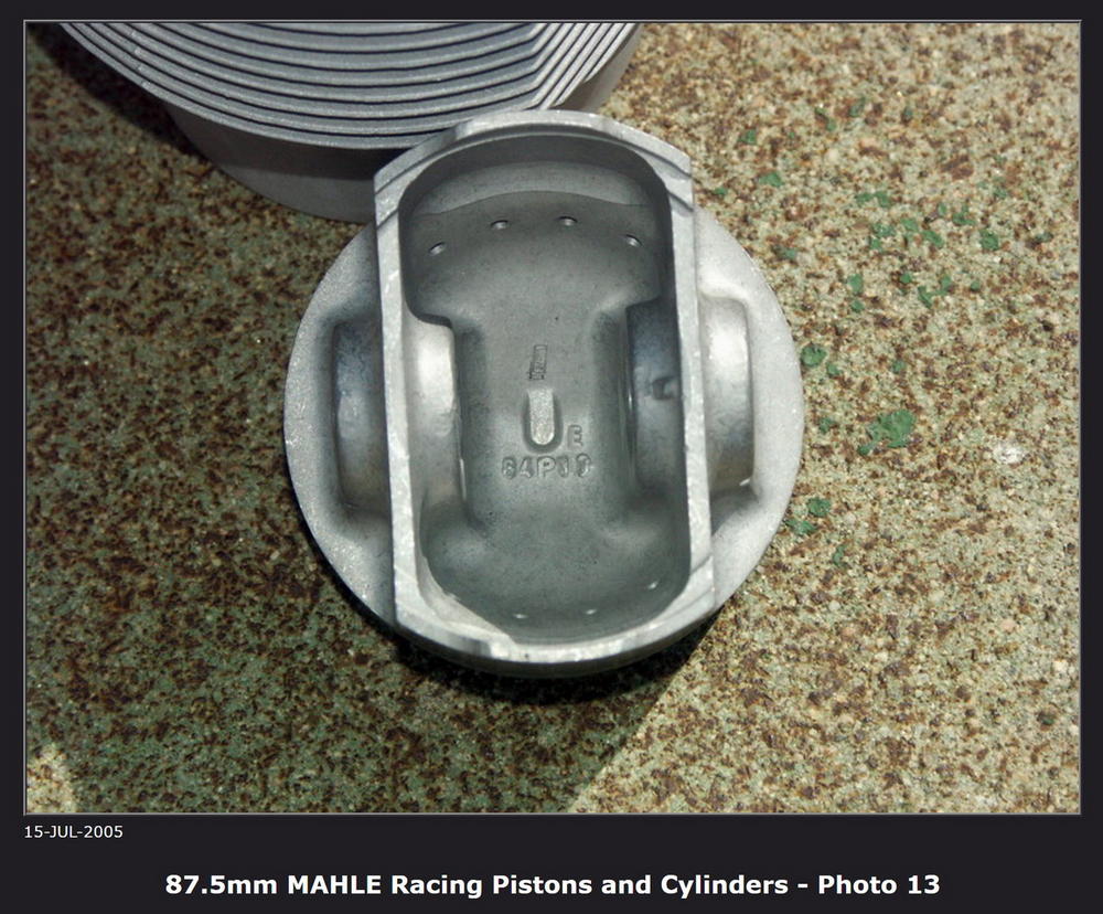

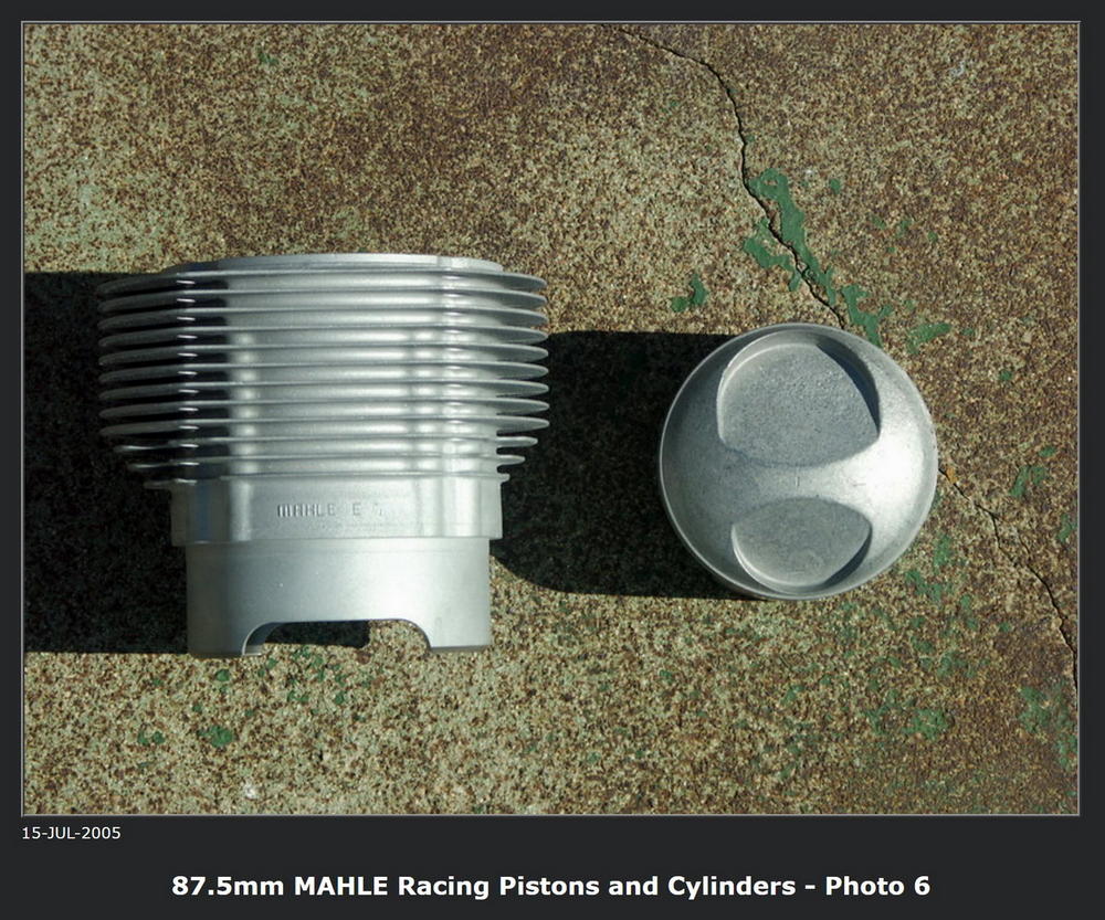

I will look for the p/n to see if I have it, but in the meantime here is a visual-reference of the 87.5mm MAHLE pistons and cylinders I had.
Attachment 410658
Attachment 410659

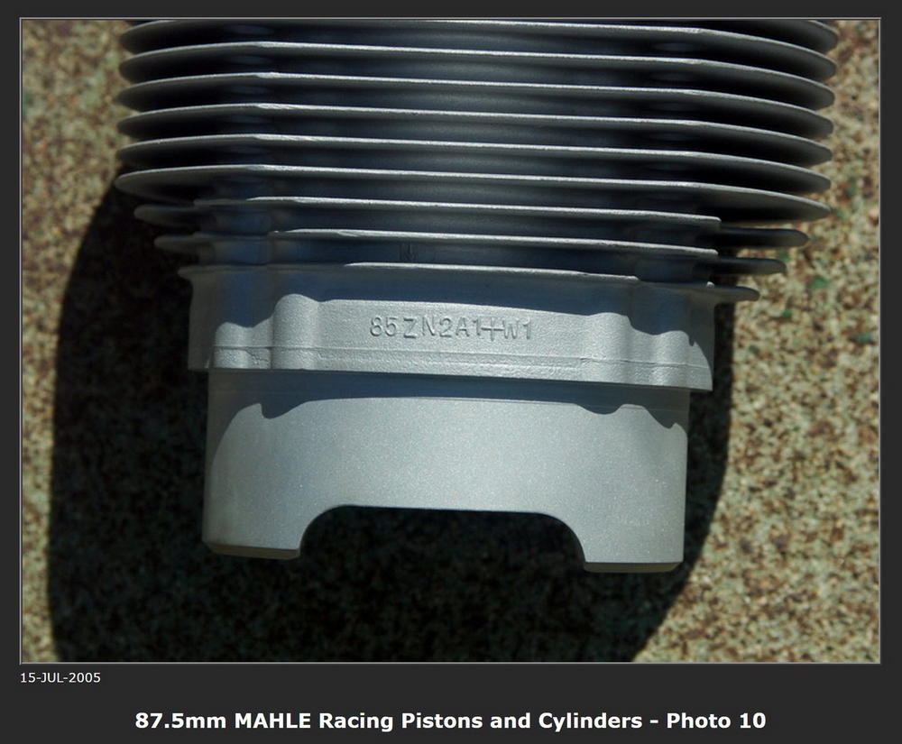

Hard to see, but the casting number should be 84 P 13
Attachment 410661
Attachment 410660
Attachment 410662
Attachment 410663

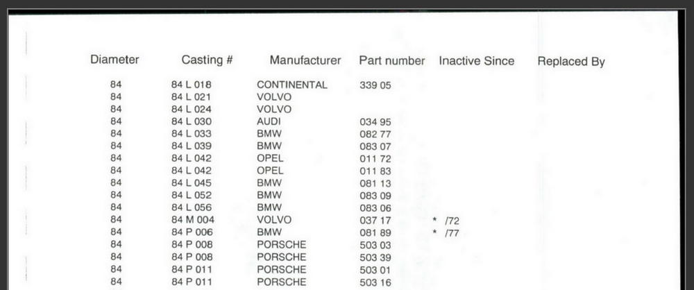

I also looked at my 1999 MAHLE Piston Casting Number Master List...
Attachment 410657
...and the piston casting '84 P 13' taken from my OEM 87.5mm ST pistons is not shown. At least not in this reference.

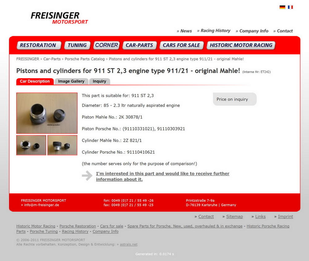

Here is what Freisinger shows for a p/n at his site.
Attachment 410656

Studying Paul Frere's discussion regarding P&Cs used in the 2.3L ST engines, he points out that the cylinders were still birals...cast iron with aluminum fins as used in production 911s. The pics posted above show nikasil cylinders, which were not used initially with the 87.5 mm pistons. When the factory developed the 2.5L ST engines, the short stroke version needed an 89 mm piston bore, which could not be done with the biral cylinders, so the 917 experience with nikasil cylinders was introduced in a 911 engine. I think nikasil cylinders were also used with the long stroke 2.5L, with pistons being 86.7 mm.
At some point later, all the 911 race Mahle P&C sets utilize nikasil cylinders, but not sure when that happened.
