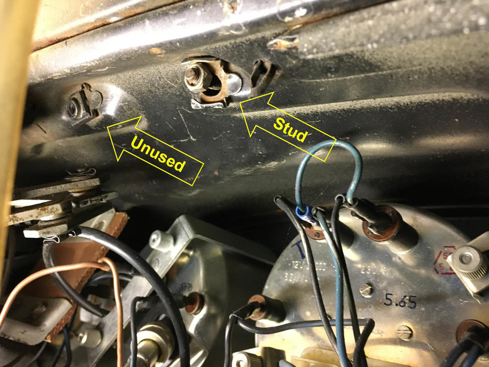

Here's the left-side dash attachment in 301382:
Those yellow arrows point to the locations where captive nuts would have engaged the two left side screws holding a "4-button" dash.
In 301382 one of the captive nuts is removed and a stud which is welded to the dash comes through (it needs a washer) to hold the front of the dash in place. The other captive nut is still in place but unused. On the right side there's also a single stud. There's nothing replacing the fifth of the "4-button's" screws.
I do know that somewhere before I got the car 301382 was in an accident and needed a new left front fender and left door.
The question:
Does anyone know whether this is an interim dash solution by the factory or a kludge to adopt a later-style dash to replace a crash-damaged "4-button" dash?
