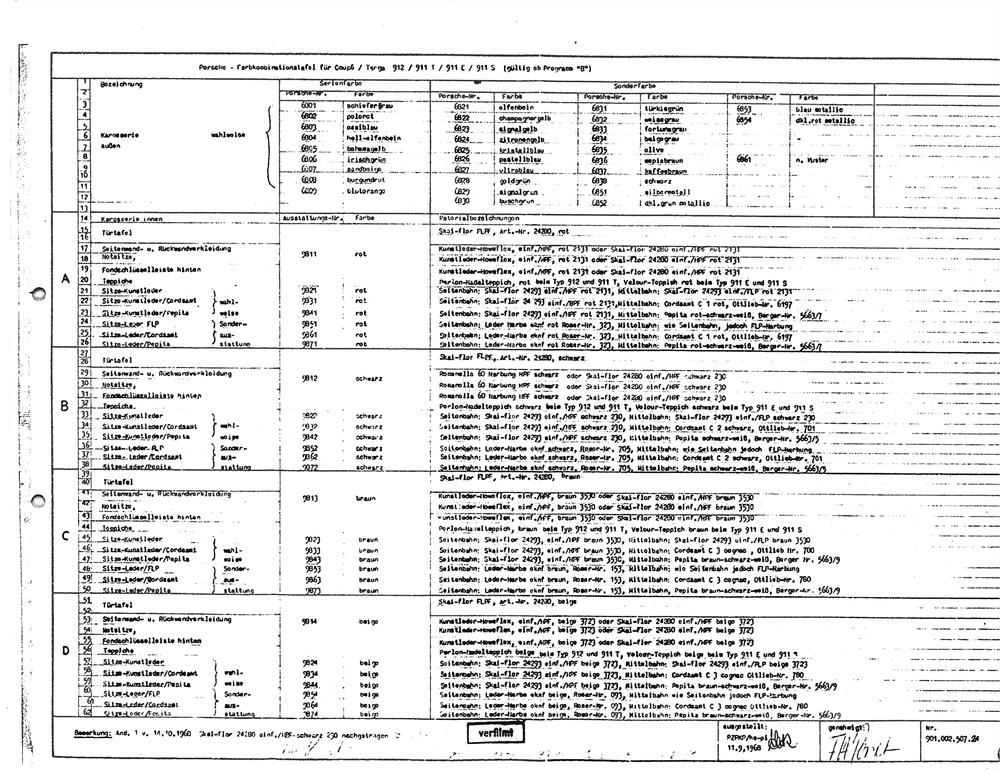

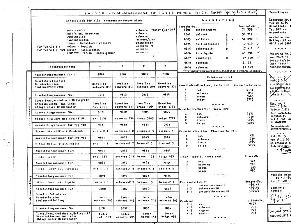

I poured the rest of my prescous Lucas Blinker Fluid into my HP All-in-One Printer Scanner and scanned the remaining sheets Porsche Classic sent me back in 1997.
Here's the single sheet I have for the 66xx paint codes.
Attachment 584498

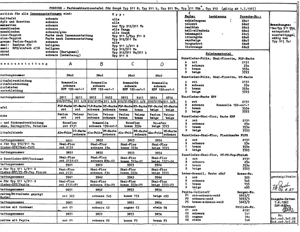

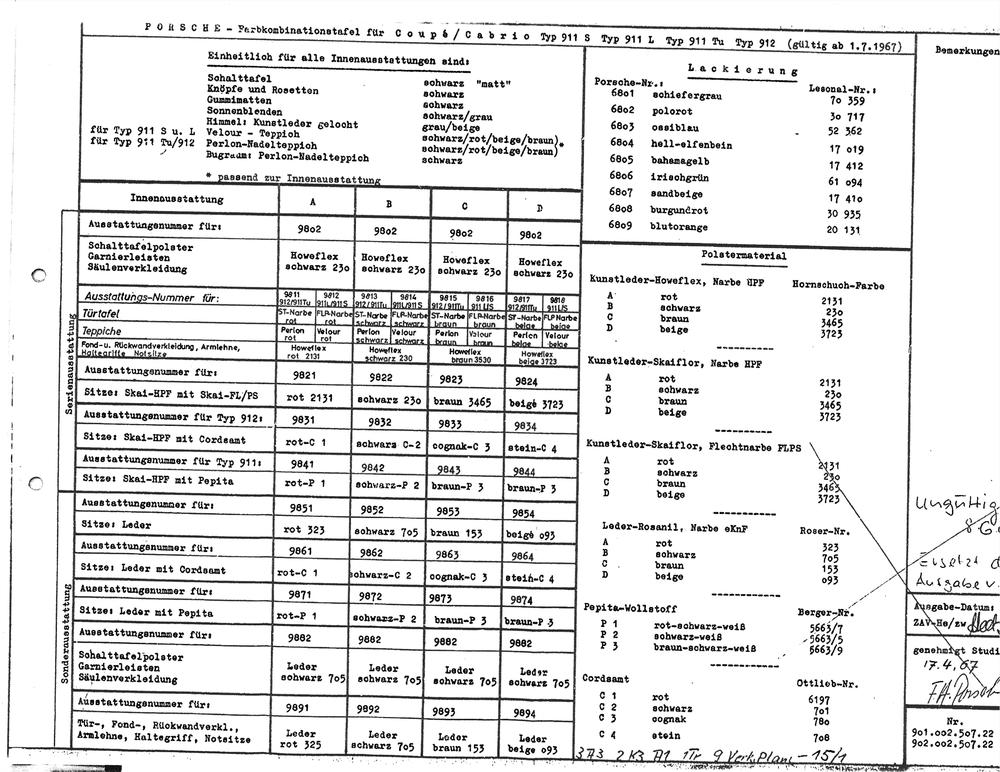

And here are the sheets for the 68xx paint codes.
Attachment 584499
Attachment 584500

Jim,
phantastic stuff….outstanding docs..thank you
