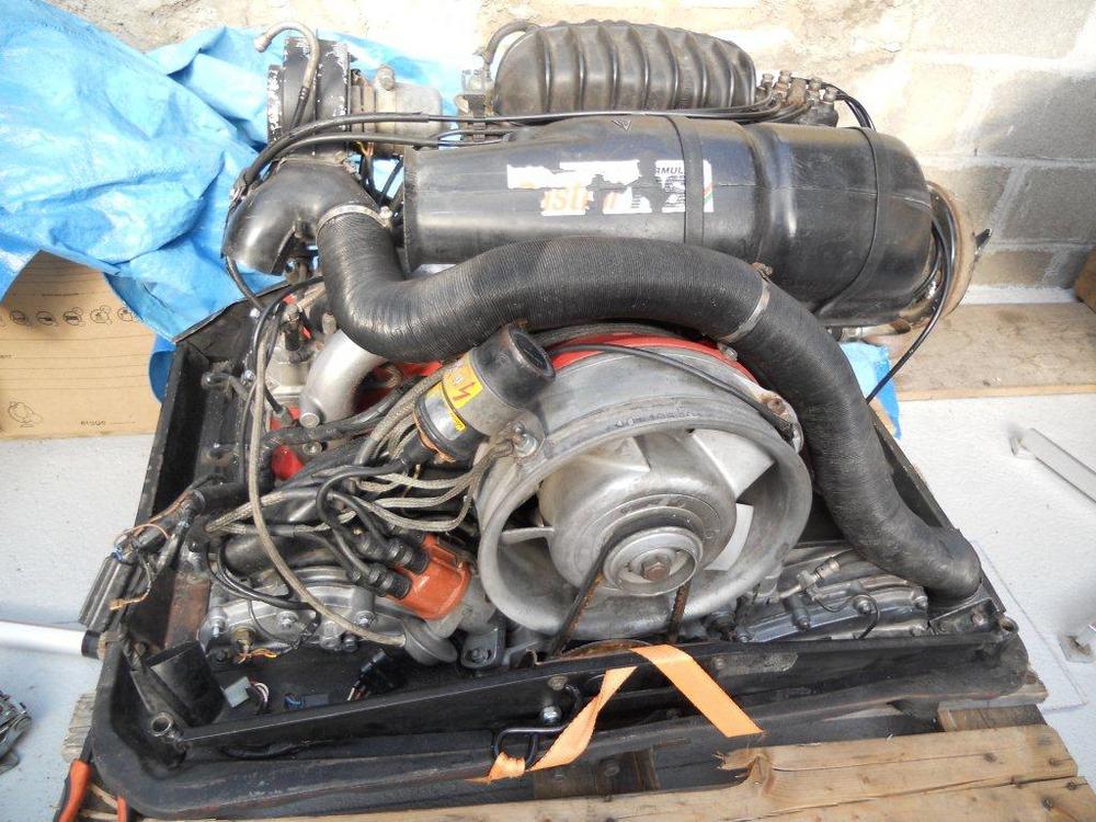

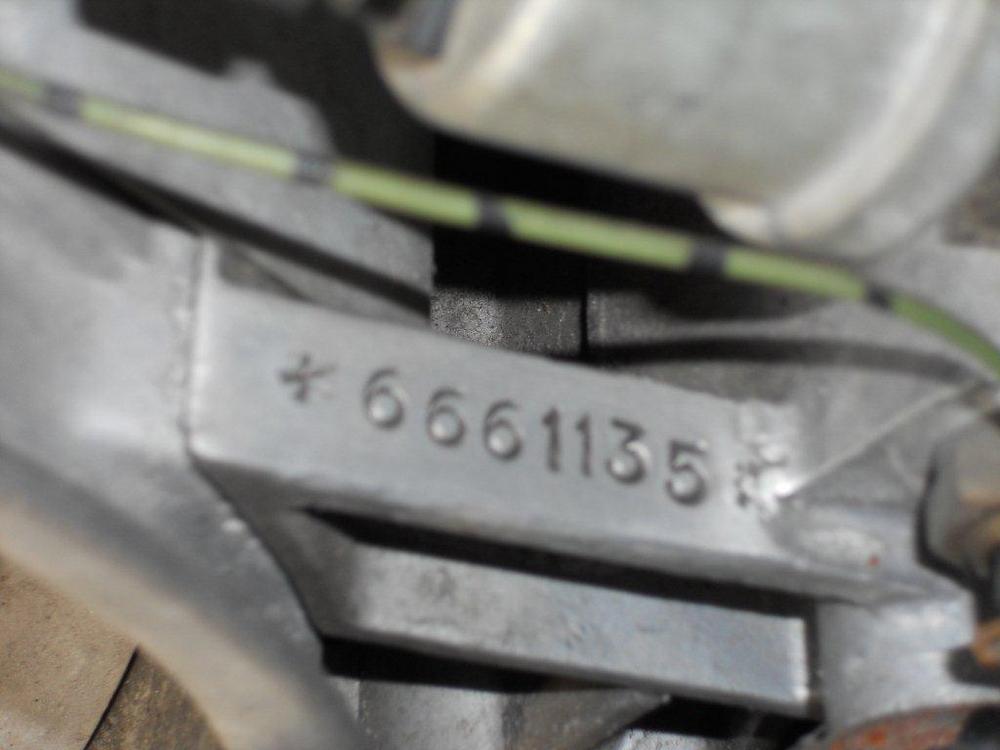

Bought a nice engine for my future project...which needs to be defined :D
Attachment 264241Attachment 264242
