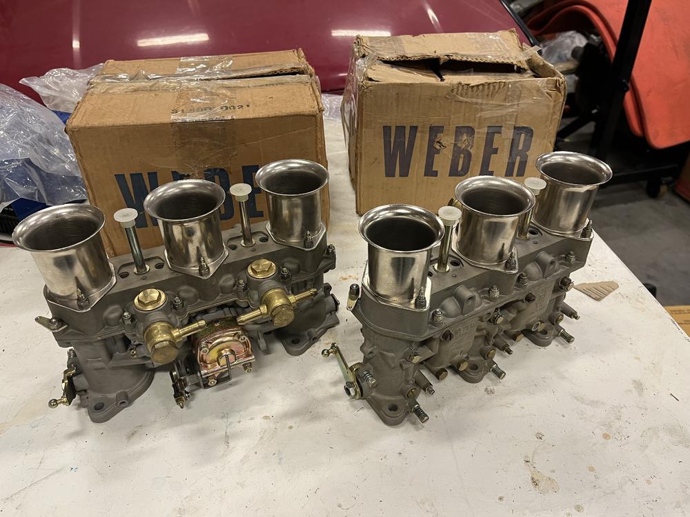

NOS Webers ..
Neither…Go with refurbished Weber 40 IDS.
Efi, PMO, Weber in that order.

I bought the NOS pair with webers here in Norway and I also have an offer on a unused set of 40mm PMO with manifolds, filters and linkage for ca $5000 also here in Norway.
It is an early T aluminium case and I have 69S heads so will be a basket case engine anyway so I dont actually need IDS. But maybe put enrichment tubes in the IDA’s.
Most important is to get a pair of good carbs that work great.
The Webers Are stamped B9 which is february 1989?
Are all Italien Webers the same/same quality?
Where's the MFI in your triage 66S:) I know, not period correct but that's what I have in my 67.
NOS Webers are perfect. PMOs do not have ability to add High Speed Enrichment Tubes but the Webers can be retrofitted with little mill work.
The 2-liter engines used heads with an included angle between the valves that was greater than later engines. Starting in 1970, this angle decreased which flattened out the dome in the heads which aided flame propagation during combustion. The HSE Tubes enrich mixture at high RPM and engine loads which caused piston breakage and burned piston issues for the 2-liter 911S engines.
If you are considering MFI as an option then also consider Webers with twin plug ignition: lower cost and complication and no flame propagation issues and no need for HSE Tubes.
Expect at something like 180HP with Webers and 69S heads, 67S heads would drop HP by 10.
Aesthetically: PMOs are wrong in an early chassis. If you build a hot rod or large displacement engine for your 1974 or later car then put PMOs on it as you like.

Kjell, I have tried both PMOs and Webers. My PMO's were new, and my Webers were 40 IDS and rebuilt to as-new condition by Paul Abbott.
Bottom line: the Webers worked better for my 2.0L (which is twin-plug). They were smoother in transition to the main circuit. If you get Webers, the high speed enrichment circuit on the IDS (versus IDA) model carbs is something I strongly recommend. On my car -- as I accelerate -- I can tell at ~5800 rpm when the extra fuel gets added to the flow from that HSE circuit.
The PMOs were fine, and I did very much like the PMO's fuel float level "windows" feature that the PMOs have and Webers do not. But the Webers are better for my car in terms of smoothness. So I prefer the Webers, especially the IDS version.

Hello Andy and Thank you for your thoughts regarding PMO vs Weber!
I have landed on Webers and will possibly add the enrichment tubes if this is fairly straight forward on these late Italien carbs. Of course if I could trade these with a pair of IDS in great condition this would be best.
