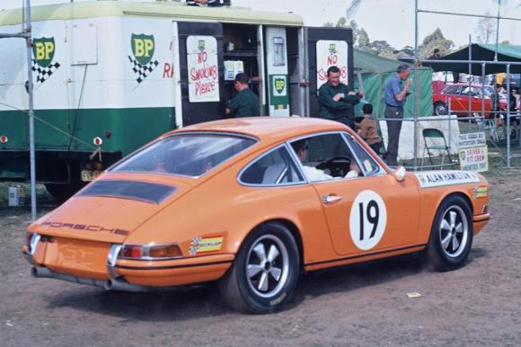

How about a one stop thread on the T/R with facts, details and pics? I would like to know more about Alan Hamilton's car. I have read that 35 were made that included 4 RHD? I know of the Gulf Blue/Orange, Gulf Blue in the for sale section of Octane, RennType's Orange and Hamilton's Yellow. Please post pics and info...repeat pictures welcomed! ;)
This is the Hamilton car (http://www.bowdensown.com.au/cars/911tr.html):

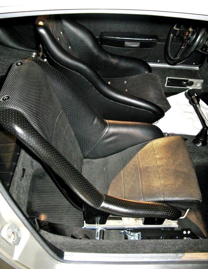

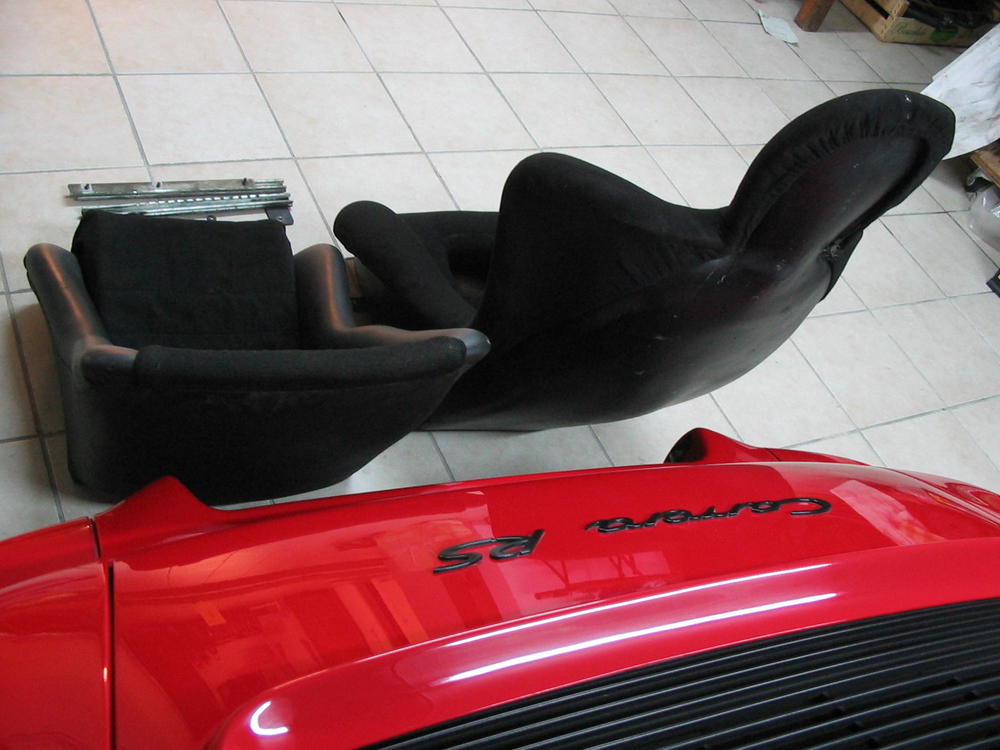

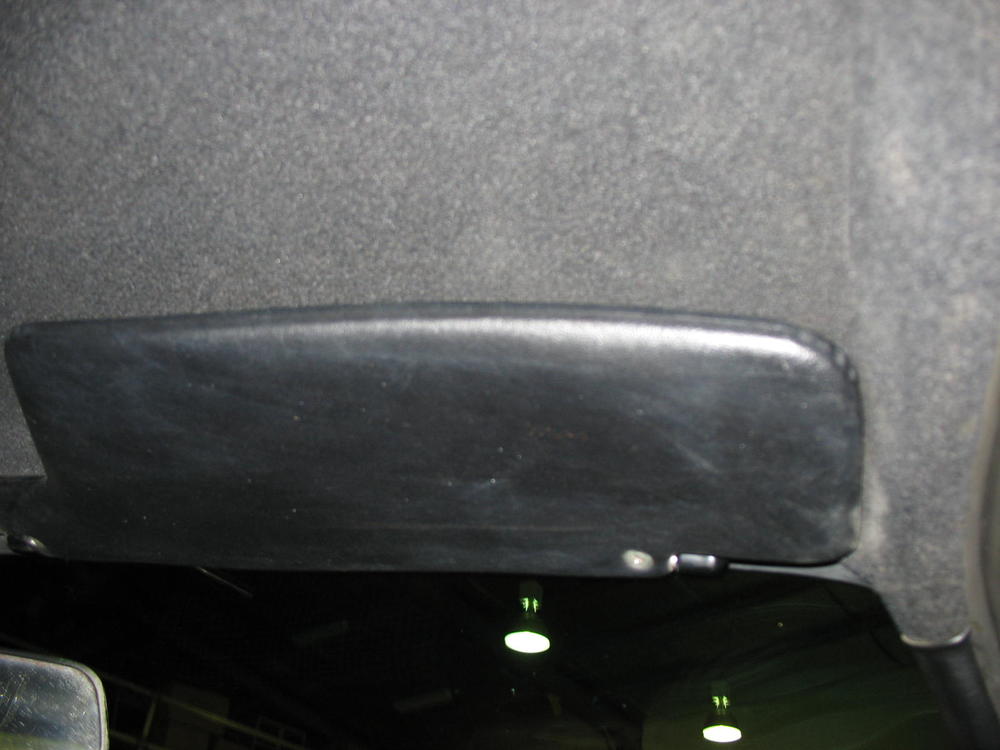

sunvisor delete and seat detail

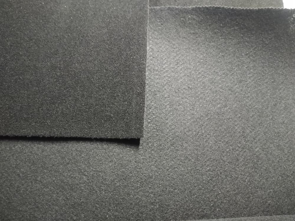

Factory T-R ltwt rear seat back
This appears to be the same factory light weight rear seat back as seen in the Hamilton car.
It is laid up from GRP with black gel coat. The outside is sprayed in black flock similar to inside glove box texture, unlike the cloth covering seen on the Hamilton examples.
Tim thinks this may be a factory Group 3 bit for saloon car racing.
This looks like something that Bob could repro for the ltwt '68 crowd!
Factory 911T ltwt rear seat rest
I have some details on the 911T (1968) rear seat backs which were offered in the 1968 Sports Purposes outline, under Kit No. 9553, this kit was for 911T for use in Group 3. The description of the back is listed as "simplified rear seat rests" no part number given. I assume the backs were part of the Kit only. The front side is black flocking, the frame inside is aluminum with steel rivets, and the inside or back i'm not sure, as the example i have, has a carpet meteral that was added later on. under this carpet the paper is black in color. Maybe original had no covering at all, like photo in above post. the seat back is made of paper, like paper mache. Yes same as glove box, door pockets ? The back is 597g. in weight, with no carpet/perlon. You can see several layers of paper in the edge photo.

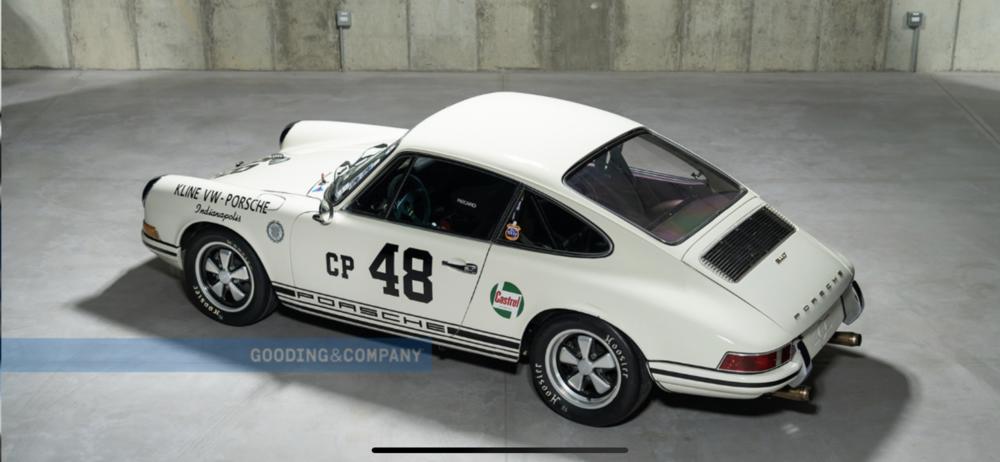

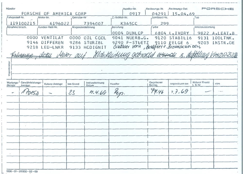

Gooding Auction offering #119100215

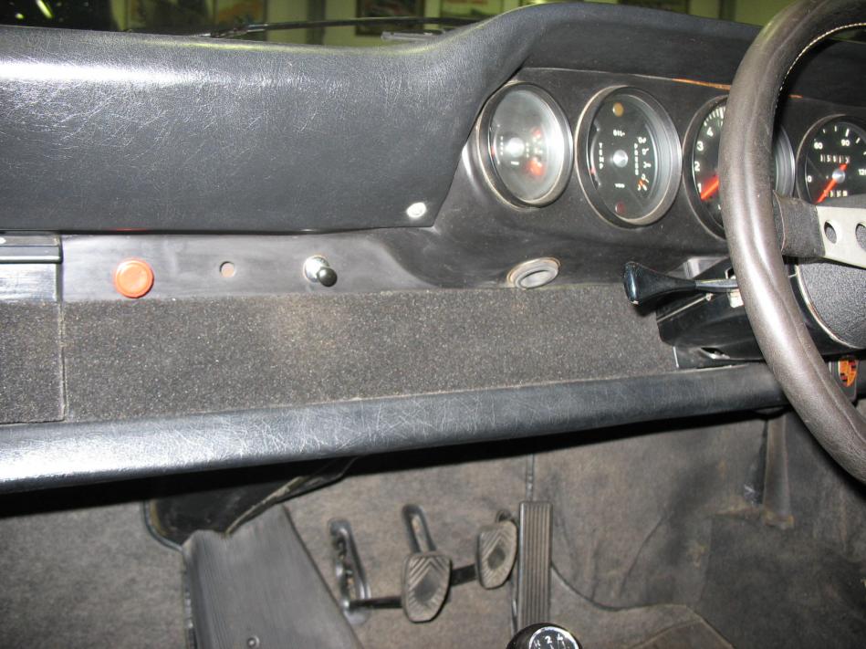

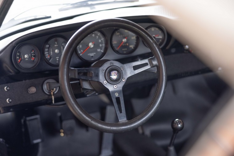

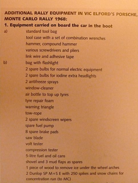

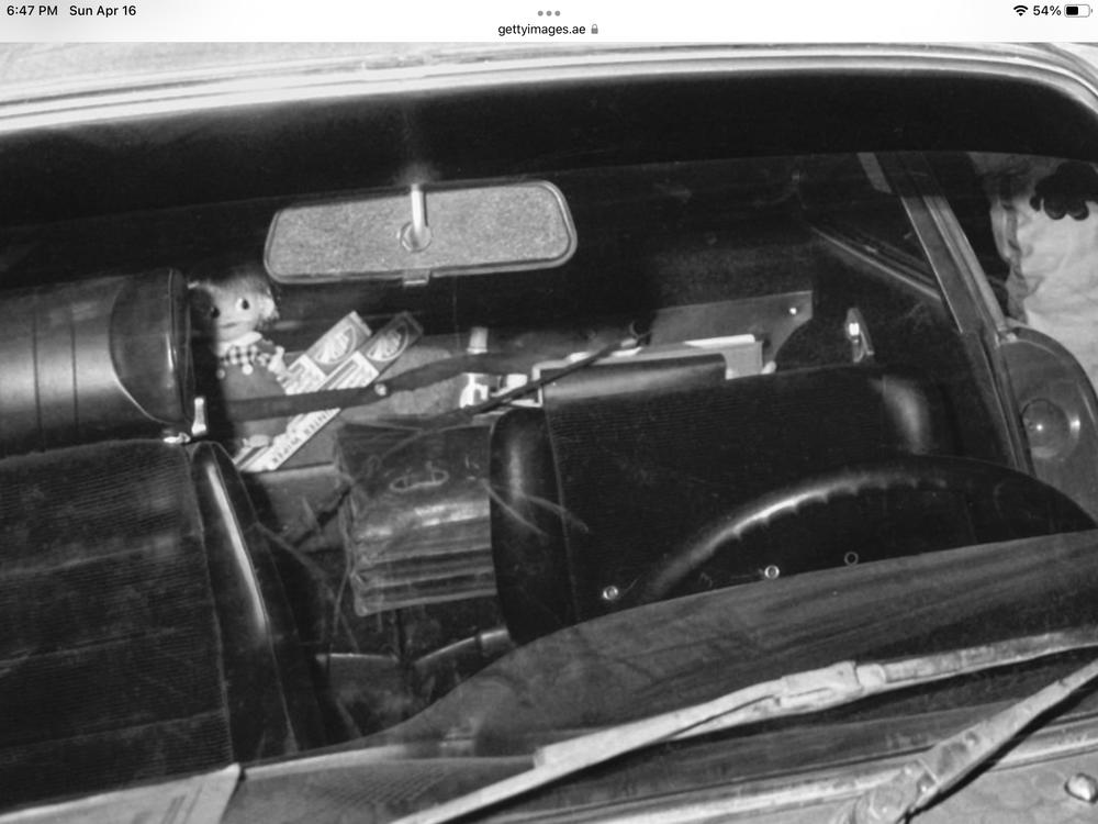

911 T/R Dashbord : steering column switches, dash trim
Hi, I am looking for pictures of the Vic Elford's 911 T/R Monte Carlo 68 : dashboard, interior, group 3.
Steering column switches are chrome or black ?
dash trim is in aluminium, black vinyl, thin black carpet or nothing ?
Thank you
