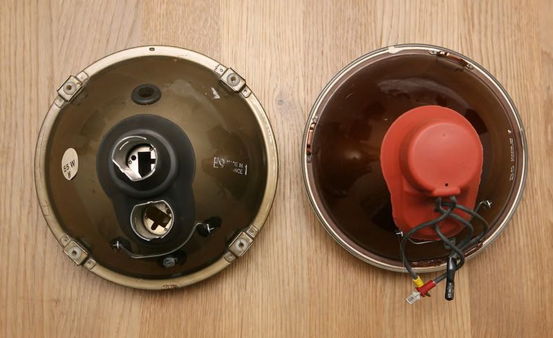

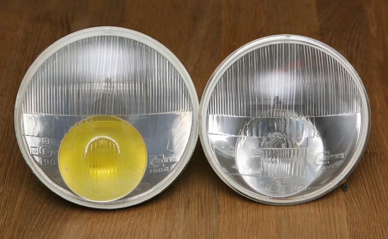

Hi Stu, yes, you're right to be cautious there are at least two different sizes of the cibie biode, I found out the hard way!
The ones on ebay are the larger 190mm versions, you need the 180mm (7") ones. I have photographed them both side by side below, you can easily see the difference. From the rear again you see the 4 mounting lugs on the larger one as opposed to the 3 on the smaller Porsche fitting one.
http://i7.photobucket.com/albums/y25...re/Biode02.jpg
http://i7.photobucket.com/albums/y25...e/biodes01.jpg

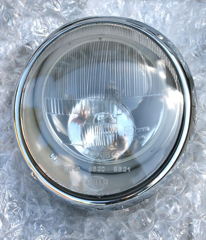

Persevere with your search, it took me quite a while and there are sharks out there who will ask for crazy money, but hopefully you may find a true enthusiast as I did who wants to help, as you can see from below it will be worth it!
http://i7.photobucket.com/albums/y25...re/cibie0b.jpg

Thanks for your insightful post and your previous thread. Because of your information, I was able to avoid falling into the same trap a few months ago. The French (Citroen biodes) and the Germans don't mix :p
Your lights look great! Nice to hear a fellow enthusiast was able to help you out.
Mike thanks for all the groundwork... I almost bought a set of the Citroen bulbs last night - but figured I needed to asky y'all for words of wisdom. Seems weird that there would be two sizes so close to each other...
