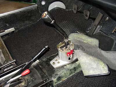

Last weekend, Curt was brave enough to let me experiment with a 915 shifter conversion on his 901 trans. setup (his Green '70 911S). Installed with the Gate Shift kit (adv. plug), it seems to work well enough to say (perhaps prematurely), there is now another shifter altenative for those with 901 transaxles. I'm asking him to try it for a couple of weeks just to be sure (see it at the next Registry breakfast).
There's more. We're also going to try the shifter out of my car. That one has the factory short shifter in it. Stay tuned.

Just to follow up on the test installation on Curtis' 911S/901 - the test period proved successful with both factory and factory short shift versions installed. In fact, Curtis did a few 8/10ths laps at the last Registry event a few weeks ago. The conclusion was a thumbs up. That's good.
Thus, the Gate Shift kit is now a fully-tested upgrade path for 901 gearboxes. You can replace your factory 901 shift housing with a 915 shift housing, aided by the Gate Shift kit and an optional, but recommended short shift kit (factory or aftermarket). The same benefits experienced by 915 owners are now available to those with a 901 gearbox.

Assuming your gearbox is in good shape (synchros and all) and the shift housing is adjusted, there are some modifications and maintenance items that will improve the shift quality whether the 915 shift housing is mounted in a 912 or 911.
The factory nylon ball socket at the end of the shift lever and the nylon bearing bush that supports the front end of the shift shaft are common wear items. Remove the shift housing to access. Replace if worn.
The shift coupler under the rear tunnel plate contains bushings that also wear. Replace with factory or aftermarket bushings.
In the shifter itself, my device adds a spring-loaded feature to the 1st/2nd gear shift plane, similar to the factory spring-loaded feature on 5th/Rev. This has the effect of causing the shift lever to return to the 3rd/4th shift plane while in neutral (if using with a 901, the springs create 2nd/3rd as the default, centered gear position). To shift, you must overcome spring tension to move into the gears toward the left or toward the right (feedback). This results in "tightening" up the shifter quite a bit and less conscious "thinking" about gear positions while driving.
