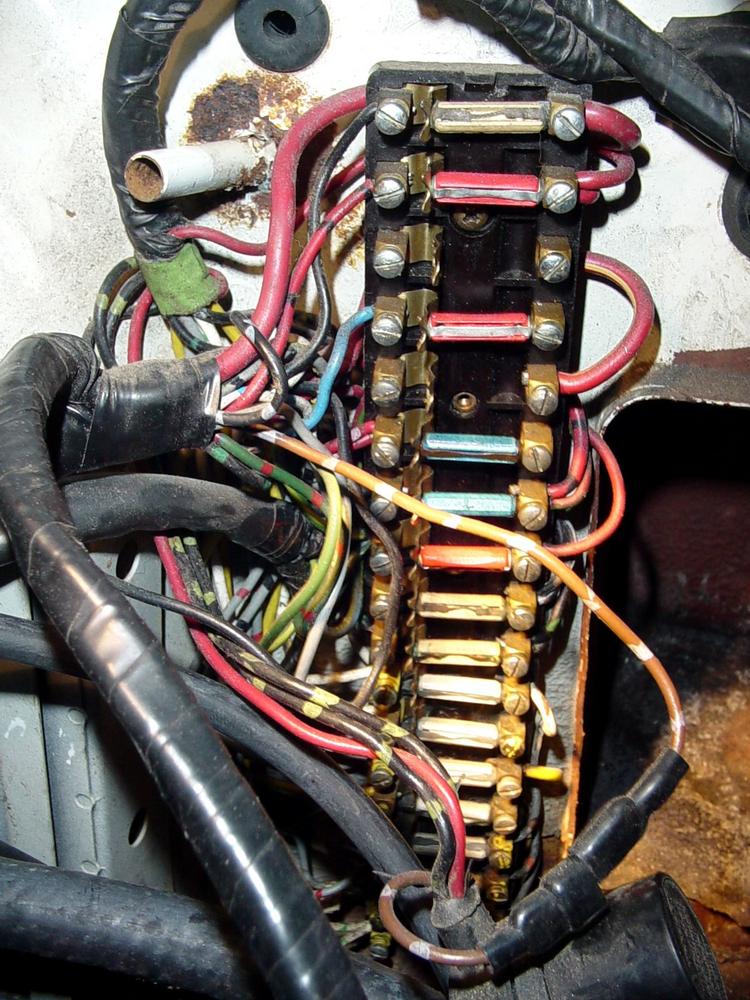

Hello I recently bought a Euro 71'T with multiple electrical issues. A little back ground it that it now has a 74' 2.7L engine and it has been switched from dual batteries to a single. There seems to be unattached wires everywhere.
My two issues I was hoping to solve first are my tachometer is not working (it lights up when I turn the lights on). Second when I use my turn signals both signals in the tachometer go on. And when I hit my brakes the signal lights in the tachometer light up solid.
Any help or at least where I should start looking for these issues would be great. I have a Haynes repair manual but is there anything better then that. Did Porsche make a legend of what color wires normally do what? I heard that brown is always ground is that correct? This is what my fuse box looks like are wires suppose to be exposed like this? Does anyone know what they are for?

Let me get one thing of out of the way. . . diagnosis of electrical issues is difficult enough when you are standing next to the car with a meter in your hand. Over the Internet it's tougher. . . and made a lot worse if prior owners have changed the wiring to non-original, such as what may have happened in the case of your 2,7 swap. So it's going to take a lot of clear photos and explanation of what you actually have in order to make progress.

Next, to your specific problem. The way the factory designed the flasher circuit, it will illuminate both bulbs when there is a problem in the circuit. The first thing you should do is take out the turn signals, very carefully, verify that the correct wires go to the correct terminals, clean all the oxidation off the contacts with a piece of emery paper until they shine bright metal, then reassemble with the correct bulbs. This is a key step in solving your issues but it probably won't solve them all- you may need a replacement flasher unit. Replacing the flasher MIGHT resolve the issue with the brake lights.
Hitting the brakes and having the turn signals light up is a more worrying issue, it's evidence that somebody has cross connected the brake light circuit. And that forward fuse panel needs some help. The wax thread to hold the wires together is original, it was just concealed underneath the factory PVC tubing that usually covers the harness up to that point. See the black wire with green stripe? that is, for example, the wiring for the car's starboard side turn signals.
First, disconnect the battery. No kidding, if the battery is connected with the wrong wiring connections you can short out wires immediately, burn the car down or worse. . . if you are not 100% positive of the connections you should seek the advice of a professional.
With the battery disconnected, carefully inspect and photograph the wires that are missing off the fuse block. Also, there are some relays and additional wires up under the dash by the gauges, and at the electrical console in the engine compartment. You want to make sure there are no loose wires hanging around that could short to the body sheet metal when you switch the power on.
This should be a good start toward finding out what you need to do. I would start by checking the turn signal connections and bulbs themselves, then work out from there, checking as you go.
Another tip from long experience-- don't use anything stronger than P21S total auto wash to clean the overspray and dirt off the wires for identification. If you use a solvent it will remove the tracer from the wires and you won't know which is which!

It will take some time to get the wiring straightened out. The engine swap will not affect the chassis wiring. First thing will be to get the wires on the correct terminals on the 2 front fuse blocks. The Pelican link above will help identify some of the wiring. One of the things to understand is the diagrams are a mirror image of the actual wiring. Here are a couple of pictures of my fuse blocks and some reversed images of the wiring diagrams.

Sadly, a wiring hacker of a PO may well have done other damaging things as well, maybe imperiling the safety of the car - it can all be fixed, but watch carefully for anything odd looking

The tachometer lighting, black/blue from the light switch, is separate from the indicator needle. You should have a red/black, black/violet, brown on the strip on the rear. Can you post a picture of the back of yours?
The 3 black/green wires hanging loose should be on fuse terminal 10. The wire going to the right front directional should be on the left side of the fuse, and the other 2 should be on the right.
Usually the reason for someone to remove those wires is they have a serious short occurring at the light unit. So use caution when you hook it all back up.
