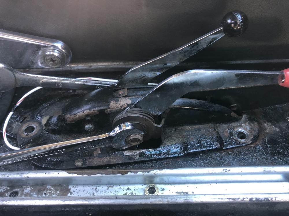

Then, undo the three 13mm bolts holding the ebrake assembly in place and then take a couple of spanners and remove the 13mm nuts holding the ebrake assembly shaft in place:
Attachment 537005
One those are out of the way, you can lift the assembly up high enough to get a needle nose plier (from the driver side) in there to remove the c-clip and push the pin out towards the passenger side.

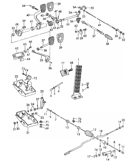

Carefully remove each of the washers and the hand throttle lever. The heater lever will remain in place. Here is a diagram for reference:
Attachment 537015

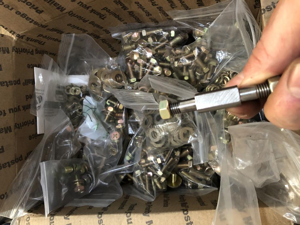

My hardware was pretty chewed up, so some new cad will go in:
Attachment 537009

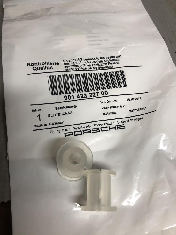

Usually the (hard rubber) hand throttle arm that pushes on the throttle cable is dried out and broken or gone completely. Mine was gone along with the washer and c-clip (I ordered two of each in the event one finds it way into a dark crack!). Here are the parts and their associated numbers:
Attachment 537010
