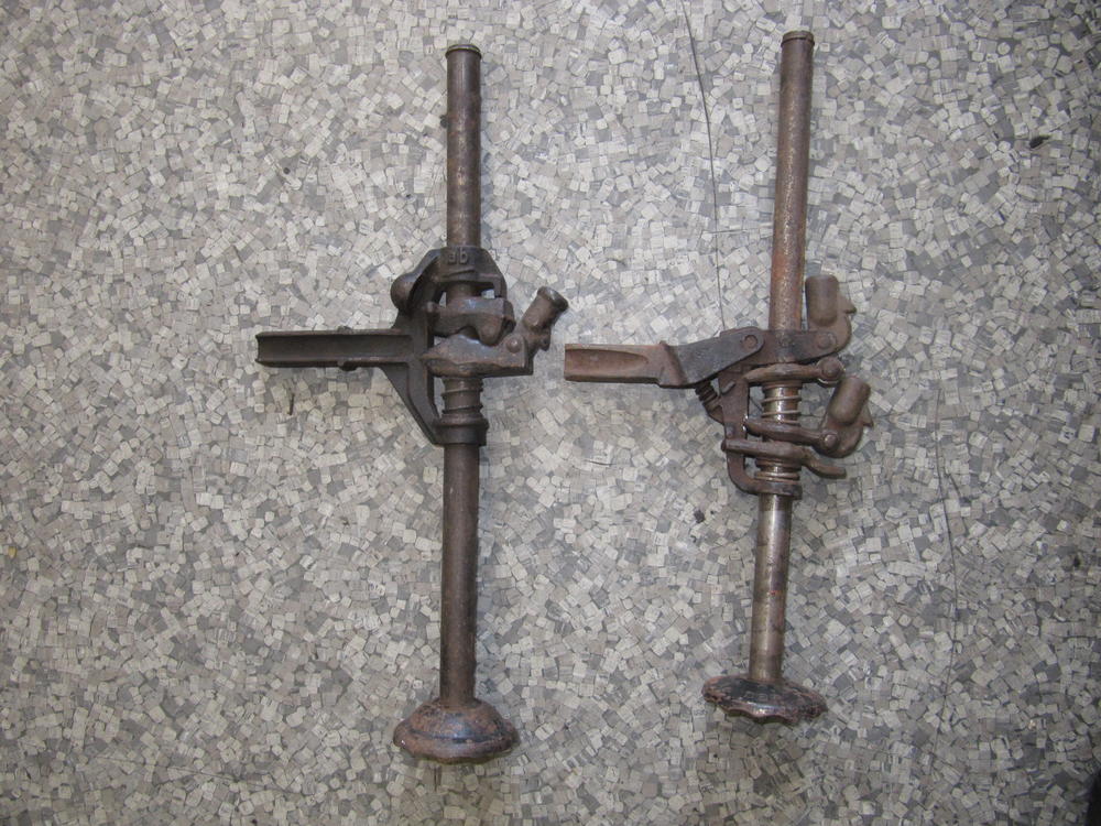

    Quote Originally Posted by Richardnew View Post
    Anyone of a picture of the '73 jack?
    This is the lever type jack MY 73 (dont think in MY 72 but you never know w transitional cars).
    This is the earlier style.
    BTW, manuals often used older pics not related to the actual MY. Its the case with 68-71 LWB manuals showing an earlier SWB 67 style jack and front trunk compartment. This pic can be found in manuals even for later models.

    Quote Originally Posted by 911T1971 View Post
    There is no rule how its located, stored or secured. It was simply placed in the trunk, often in the area in front of the spare/space saver wheel. The factory did not provide any securing mechanism or strap on early's.
    Karim
    Your comment about pictures in owner's manuals is right on the money!
    The crank up jack you have pictured is from a 73 or later 914 and the early jack is from a VW and could possibly do serious damage to the side of a 911, if used. It is my belief that 911 crank up jacks have a solid cast metal probe and the 914 jacks have a stamped steel probe. The early 911 jacks (approximately 70 - 72 years) have a probe that pivots from 90 degrees to 60 or 70 degrees. The VW ones just stay at 90 degrees and should never be used on any 356 or 911/912 Porsche. You also make a valid point about "transitional" years. It could very well be true that the crank up jack you have pictured did come from a 73 911 and it wasn't until later that 911s got the solid metal probe.
    Jim

    thx Jim about this important precision. Didnt know these details and without your input, we would be wrong.
    At least my pics do give a visual info (coming from my archive and sometimes are not dated) but your technical input close the case. BTW, jack pictures are from older post and cars I used to record.
