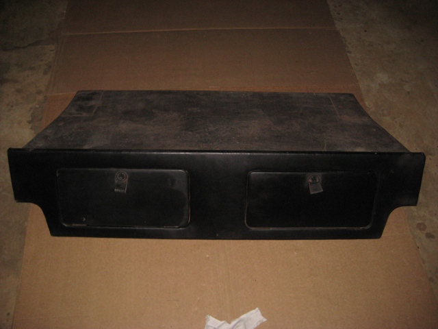

    That's my my "rear storage deposit". I took a stab at the hatch dimensions and so on. It was a pretty simple build. I still have the template for the face and since finishing the project I purchased two factory hatches. I'll use them to fine tune the template as I plan on building another with better factory appearing hinges and better quality vinyl
    I cut out a cardboard pattern. I then cut out the template from 1/4 in plywood and scribed it for fit. The material used for the
    final structure was 1/2 in russian birch plywood.
Size:  84.9 KBName:  shelf+with+doors+on+floor1138389001.jpg
Size:  84.1 KBName:  shelf+backside+latch1138389081.jpg
    This is the example I worked from, but used metal "L" brackets rather than wood gussets.
    Chris
    a factory unit
