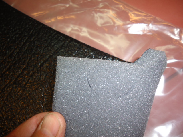

    Item one is the insulating pad for the engine compartment. Its been years since I last bought one of these, and what I got from the vendor was not really what I expected. It is light as a feather. Came rolled up with a couple of rubber bands around it, not flat or folded like they used to be. I can't imagine it being very durable, or having much impact on sound. It is a very light foam material sort of "shellacked" on one side with what looks like black PVC glue. It has a semi-official looking part number of 911.556.891.01. Is this just what is now currently available, or a cut rate part from the vendor?

    Pictures of what you got would help. The new factory pad is much better than the original, lighter and closed cell as opposed to open cell. Better foam as the original would absorb water fall down and then fall apart with dust everywhere. These are really wear parts as they last about 10 years.
    + 1 .......... Over 3 lbs. lighter, easier to put in, does not fall apart from age or it's own weight.....

    Thanks guys for your replies. I remember the old ones fall apart under their own weight, and they never lasted very long. The new one just surprised me how light and seemingly insubstantial it was. Maybe the pad I have is OK, and an improvement over the old ones? Photos below. Should I use it, or search elsewhere? The appbiz product suggested above sound promising. While I like originality, I'll always give the nod to something that works well, compared to something that just looks correct.

    I have said in the past, I would not use these foam pads again? Only piece left of the foam pad is the light piece right of the fan housing with the outer skin burned -off and the inner foam piece remaining... (1st & 3rd picture ) cliff
