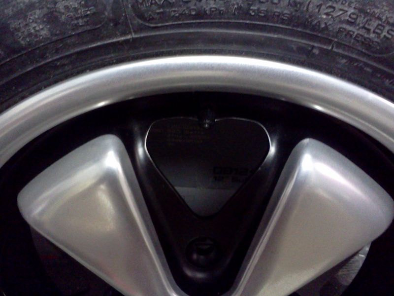

    Thank you for your reply, much appreciated. Here are the photo's of the wheel. I understand it was restored by Harvey. I am sure it is the correct finish but would like confirmation.

    Judging by the paint lines I don't think that's Harvey's work.

    We didn't restore that wheel.
    You can see the outer "frosted" offset was taped and blasted.
    We anodize that area with a soft edge finish just like Fuchs did.
    Also they missed the sides of the spokes with the rough finish and the paint line is not a close as ours.

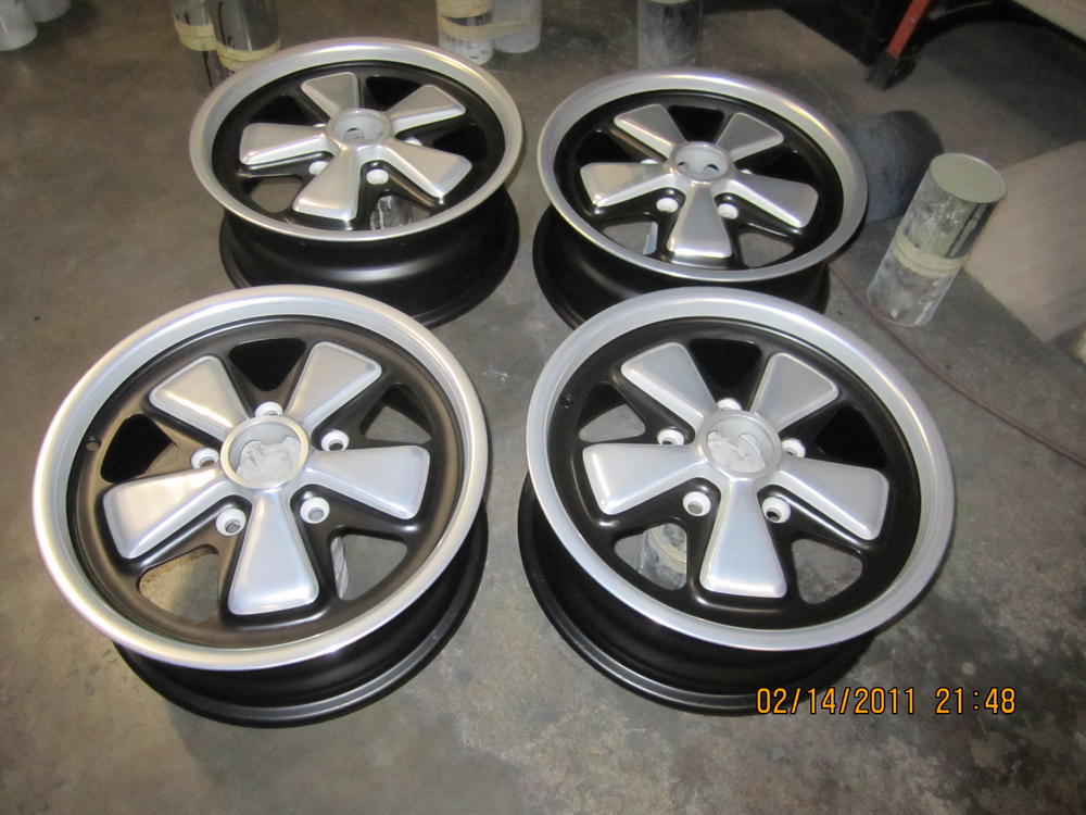

    I can't find a decent photo right now.
    The flash makes the anodize look different than in natural light. The deep 6 is the small photo.
