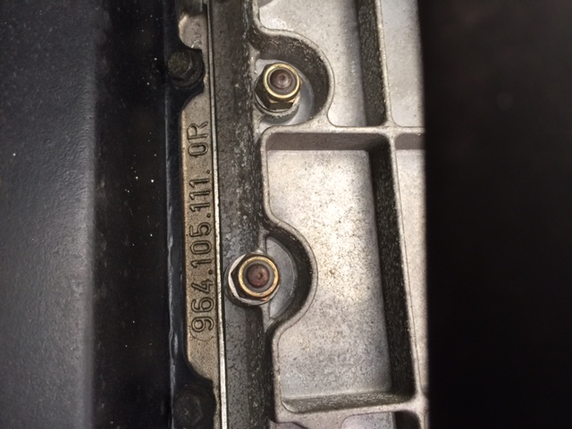

    I'm trying to make sense of the engine numbers for a '69T I purchased a few months ago. I searched the registry but haven't found much pertaining to the numbers on the case, heads and fan upright. The motor is not original to the car so I don't know the exact build specs of the motor. Any input and direction would be great. Thanks!

    Well...your case appears to be from a 3.2 L SC...

    I doubt anyone will make sense of the eng number except the guy who stamped it; that's not a factory stamp.
    Definitely a late motor.
    Anytime we go into these "blind motor" scenarios we usually dyno and check cam number on end of the cam; that will tell you what state of tune.
    If it's got MFI and not carbs you've probably got a mildly hot motor there; one that someone spent some dough building.
    If it has 40IDA's and small venturis then it's probably a stock CIS/DME motor with carbs thrown on it.
    (The A/C pulley and no A/C would lead me to believe it's probably a stock motor.)
    How about pics of intake and exhaust?

    The case is probably a 3.0 SC case as it has sump plate castings. When the 964's came out all replacement parts that are interchangeable with earlier castings were changed. I bought a new cam housing in like 1990 for an early small journal application and it had 964 casting #. So the above engine is a mix of parts for sure.

    This is my thread on the case casting revisions; as in your first photo:
