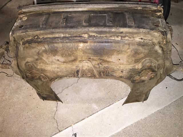

In my quest to find parts for my car, I found this front clip on eBay and paid $800 delivered. Since it's the only one I've seen for sale, I think I got a good deal.
It appears to have been from a salvage yard disassemble, the wires were cut with the body. The tag is # 11870160, indicating (per Red Book) a 1968 911 T Targa.
I plan on disassembling by the spot welds and using parts of the lower wheel houses and maybe the suspension pan. The gas tank support has been replaced with a 74-89 unit. I found evidence of mig welding and the workmanship appears to be of good quality.
I'll be selling the parts that I don't use on my car.
If anybody has that car, they are welcome to the tag.
