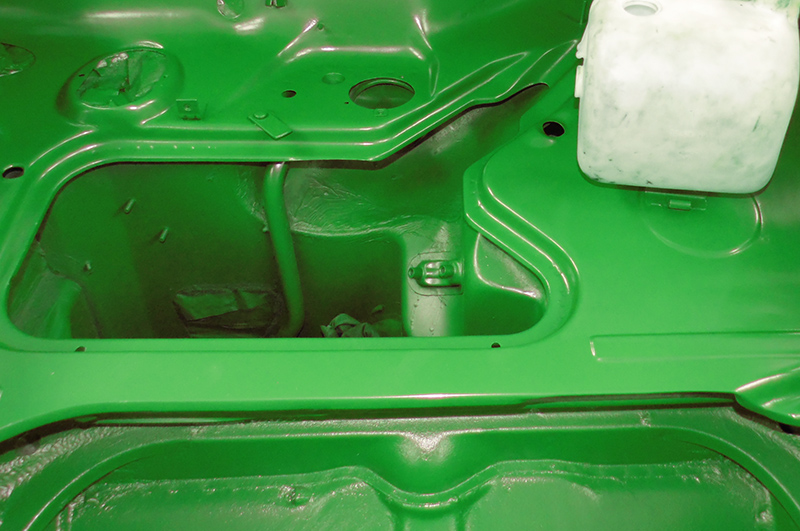

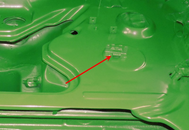

    I have a 71 E car with the factory air condition.
    Is this place correct for the windscreen washing bottle?
    Front of the trunk is the AC air blower

    yep........but i think you have tu turn the bottle 180 degree.....hmmmm not up side down of course

    Here's a pic of the setup. It was a (356 if I remember correctly...Stoddards) battery strap that holds the bottle in place. Back in the day, they would just attatch the strap to the blower motor cover. I'd recommmend a little bracket. You'll also find a little plug up front to cover up the non a/c bottle hole.
