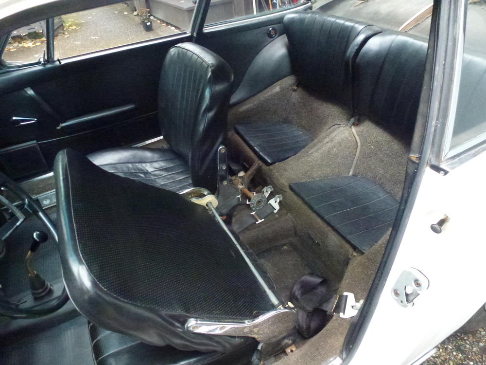

    Here is a photo of my old 6/1965 built 912. The seats are believed to be original and have 5 pleats. The back side of the seats had perforations also.
