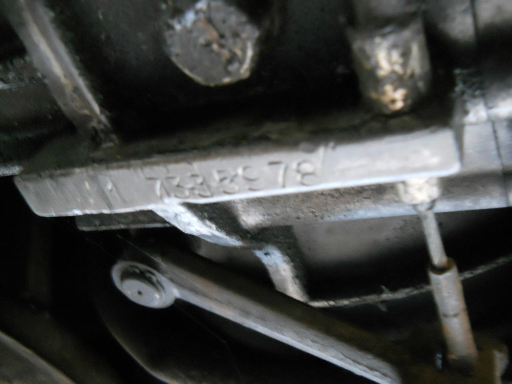

    This car was discussed in the "911S Cars for Sale" sticky.
    14,371
    VIN = (cut-out)
    Eng# = 6133941
    Trans# = 7335978
    Prod# = ?
    14,371
    Missing

    Meanwhile . . . the engine and trans numbers are here, now, so . . .
