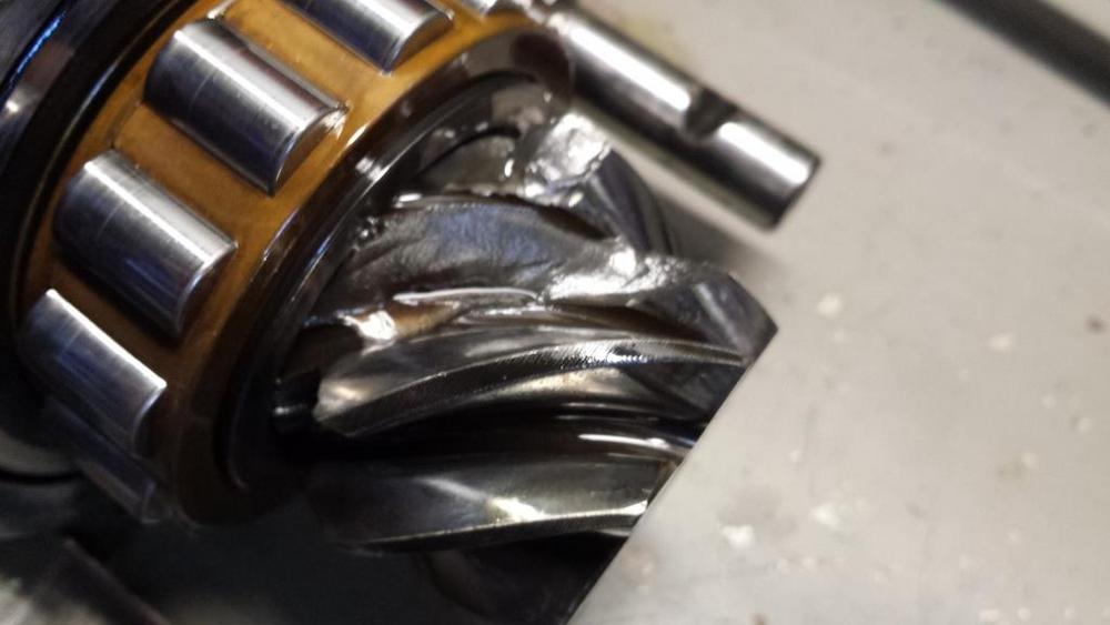

    A little while ago I started to hear an increase in the noise from the (915) gearbox in my 1973 911E. The car has done about 230,000 miles and had the gearbox refreshed about 90,000 miles ago. It has E cams but apart from that is basically 2.7RS spec with 2.7 P&C's, S induction, RS space cam in MFI pump etc so has a bit more Torque than a RS but probably nowhere near some track cars or big engine transplants.
    The noise was noticeable in 4th and 5th gear under very low load on the engine. any more acceleration it could not be heard and it was absent under no load or with clutch in. I felt it was a "final drive" issue just by the sound of it and how it presented although it was suggested it could be gearbox bearing noise.
    Anyway, bearing noise or not, I decided that safe was better than sorry and I should get the gearbox pulled down and fixed sooner rather than later. I was very surprised however when this was found:

    So on last Saturday morning I was told that the pinion in the 7:31 final drive was in the process of self destructing
