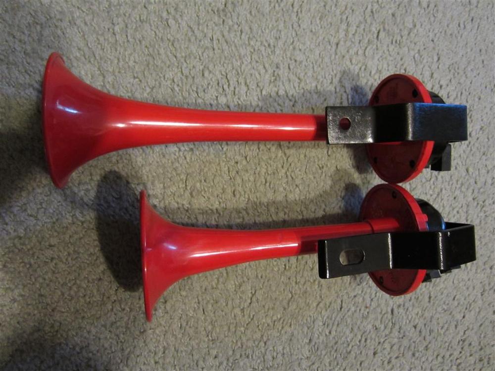

    I've always gotten the answer I sought on this helpful site so here goes. On my Jan.'72 car I have these red Bosch air horns. I have no idea if they're original or not. Can anybody tell me what the applications were for these horns and if they might have been original on the car? Third pic is of the air compressor for the horns (I think anyway). The last pic is of a pair of red trumpet horns that I have. The trumpets came off a '73 that I dismantled back in '93. What is the correct horn for a Jan. of '72 car? I don't know if I need banjos or trumpets or if these air horns might have been original. I don't really want to buy another set of horns. Other threads I've read have failed to definitively determine what I need. Please help. Thanks in advance
    If anybody knows which horns sound better or how they sound different please chime in too.Name:  20141222_154039.jpg

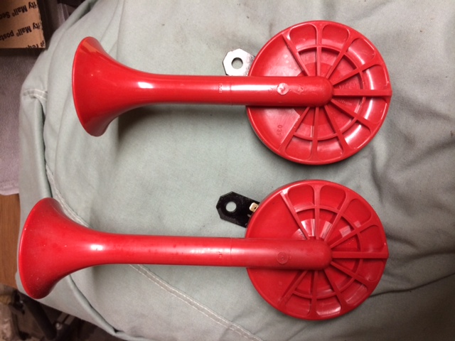

    Air Horns are aftermarket. Bottom trumpets are for 1973. '72 should be red banjo.

    That's kind of what I'm afraid of. I also have a pair of all black horns off an SC or Carrera. So apparently I have virtually every kind of horn except for the one I need.

    Those red trumpets you have are very valuable. You can sell those and more than cover the cost of the banjos.

    Jay, the ones I posted are '72 Banjo. My '73.5 came with this style Trumpet.

    Ah. Phew. That's what I recall of mine. I will say that of all my cars, the 73.5 horns have the best sound - great authority, but beautiful, high quality, sports car sound.

    I've gone with the wisdom that MY '73 cars produced BEFORE Jan '73 (i.e. in '72) came with the "banjo" horns. '73 MY cars produced in '73 came with "trumpet" horns.
    NOW to cut to the chase, your air horns are not right in any 1973 scenario. You'd probably do best to pick up a set of red "trumpets". The good thing is that they were produced for some time after the "banjo" horns and availability is much better.
