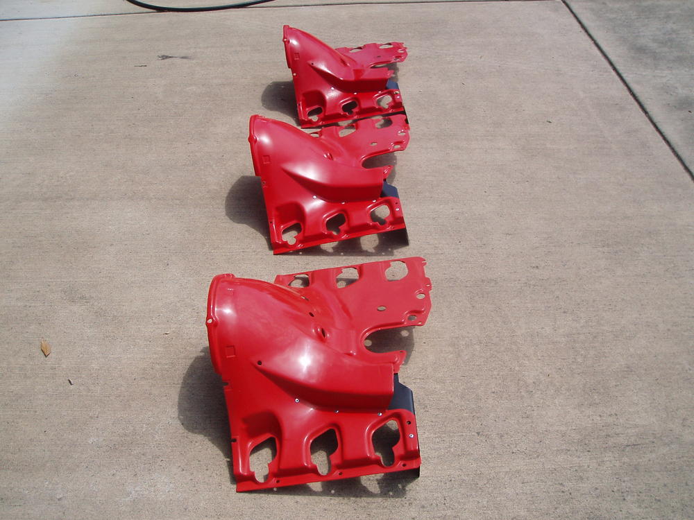

    The first two shrouds in the foreground are the 73 only with the soft shape to the oil cooler duct. The third shroud has the late 73, 74--> more angular shape. Gled

    Chuck, is that the original shroud for your car? Sepia has the late shroud also, # 13xx, June production I think. April is pretty early for that change over. I wonder what the earliest car in 73 is to have the late shroud? Gled
    12,460
    Yep......... As far as I know.
