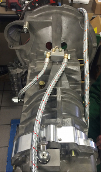

    Finished and mounted ( with Nosgruppe repro strengthened side plate )
    What a masterpiece....
    The little oil filter is specially made by my friend Andrea Malpassi ( best known for pressure regulator fuel filter "Filter King"). Very cool and very old looking..
