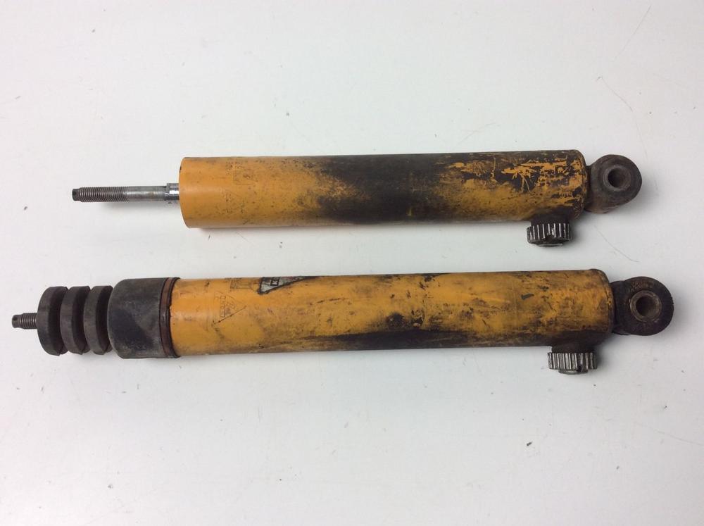

    What yrs shocks are these please. :D
    Anyone know the year these stocks will fit ? 8210K
    SWB.. LWB or 72+
    thx..

    I'm pretty sure that they came from the rear of a Borgward Isabella TS. I'm sure that they are really expensive, though!

    Oh Nice Koni still will rebuild them Killer!!! .. thanks! ..
    I guess test fit different 911's to see perhaps???

    I have a hard time believing that Koni can't tell you the application.
    Give them a call. I know it's less scientific than trying them on three different 911 geometries but, hey,,,

    I'll be at Koni today. Will check for you.

    Koni said:
    They are a double-adjustable cartridge-type shock that could fit a variety of vehicles depending on the attachment parts used. In other words, it starts life as a 'generic' shock.
    They suggested to measure 1) the compressed length overall, 2) the extended length overall, 3) the bolt size of the lower mounting eye, and 4) the thread specs for the upper end. Compare to a stock Porsche shock. They are rebuildable, also.

    I was right, after all!
