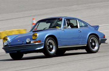

    My '73 was a full trick auto crosser/track car. Huge sway bars and hard bushings. I even had Derek Bell test drive the car on the track. Basically the car became a PITA on the street. It's was a great track car though.
    I'm now back to stock 911S all around on the car and it's a joy to drive on the street. I'm replacing the hard bushings with stock rubber bushings and that makes the car much more pleasant for daily use.
    Name:  911 @ Homestead.jpg
    I'm glad I had a nice track car but I'm also glad I can enjoy the car this way. Basically you just have to decide what you're going to do with your car.
