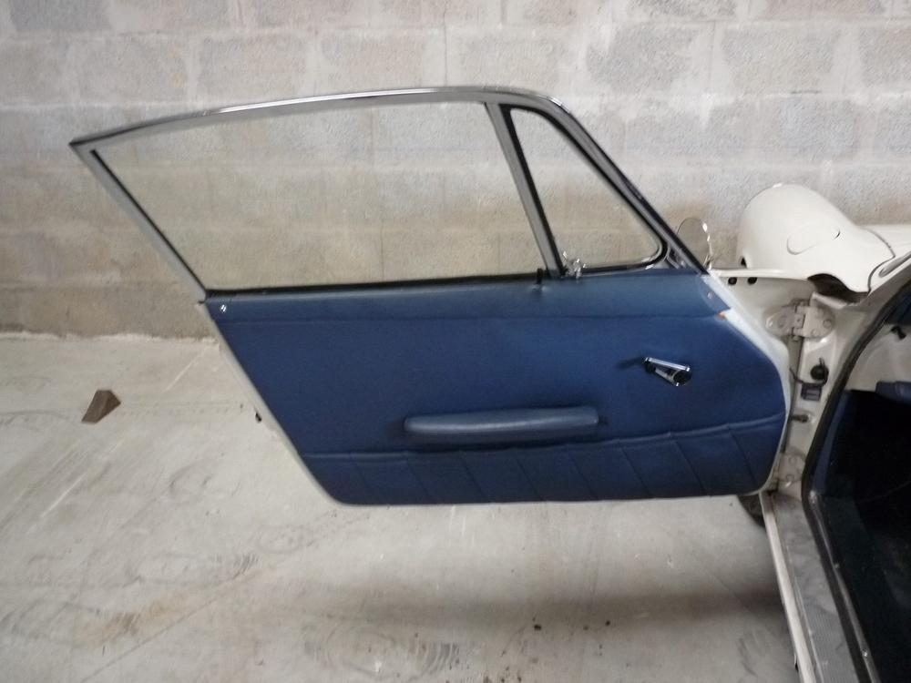

    what is the vin of your car, because then we can check in the thread with the 64/65 mj changes concerning the high rims on the back seat. I´ve seen blue interior already with white exterior on an original 65 912 at the french coast. very nice, very "marine style" and beautiful.
    The armrests had been blue...etc..but have a look at it . .
    59 750 pre unit triton

    Hi Haul, thanks for the pictures! Indeed a beautiful combination.
    Is it an original interior? Looks like the parcel shelf is black or am I mistaken?
    My vin is 302831.
    Thanks

    Quote Originally Posted by haul View Post
    Semjon,
    what is the vin of your car, because then we can check in the thread with the 64/65 mj changes concerning the high rims on the back seat. I´ve seen blue interior already with white exterior on an original 65 912 at the french coast. very nice, very "marine style" and beautiful.The armrests had been blue...etc..but have a look at it . .
    Pretty sure that 65 912 isn't original. You could always order full custom leather with dash and arm rests etc....
    but that car is suspect at being original because in part because of the late right lock post....
    The car has had some deep repairs...
    I would like to see the inside of the door cards before I would claim it was original...JMHO
