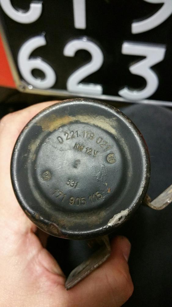

    Good, correct '68 ballast resistor. Make sure the resistance value is 0.9 ohms. I don't know what that coil is, maybe from an Opel? What is part number on the bottom and what is primary resistance measured between the screw terminals (you will have to disconnect everything).

    I did some resistance checks ob ballast resistor and coil. The first gave me a value of 1.2 ohm and the second 2.1. 304065, are these value correct? I followed your drawing and i have connected alle the wires in the right places. Thank you very much!
    Regarding the type of coil it is a vw one, maybe installed on a jetta. I have two of them. Please see the picture below. Bosch code should be the one that was used to supersede the factory installation code.

    All right. One other limitation of the 1960s Kettering-Ignition is that the points can switch a maximum of about four amps. Any higher than that and they will not last or function reliably. So . . . a little ohm's law:
    12V (nominal) battery voltage divided by four amps = 3 ohms primary resistance. If you look at the original SWB coils, they have a 2.1 ohm primary resistance. The early ones look like this, they are a little different for '68.
    Now, that is used with a 0.9 ohm ballast resistor. . . 2.1 + 0.9 = 3 ohms, for four amp maximum points current.
    Your setup. . . 1.2 ohm resistor + 2.1 ohm coil = 3.3 ohms primary resistance, for 3.64 amps maximum points current! This practically means that you will experience more difficult starting when cold, and at HIGH rpm, you MIGHT experience ignition breakup, just when you need it the most!

    So. . . my recommendation is to either a) see if you can find a lower-resistance ceramic ballast resistor, such as off a Mercedes of the period, if you can't find a Porsche one, or b) source a lower-resistance coil (which may be hard to find).

    Just one question. If i touch the two leads of my multimeter i read 0.3 omhs, due to the resistance of the multimeter wires, i guess. Does it make any sense to subtract 0.3 omhs to every measurement? In that case i would have 0.9 for ballast, 1.9 for the coil and around 4.2 amps to the points...
    Ge, Bravo! You have found the problem! Yes, if your multimeter does not zero out the ohms measurement, then it is measuring the resistance of the test leads AND the resistor in series. It is likely that your ballast is 0.9 (you can see it stamped on the side, or take a photo and post it here), the coil, being a VW Jetta part, was likely designed for electronic ignition that uses a solid-state transistor to switch the coil current, and as such can handle a few more amps (Modern Bosch stuff switches like 10A)-- so it has lower primary resistance, that makes sense.
    At 4.2 amps to the points I would be OK with operating it, this should not be a problem.
