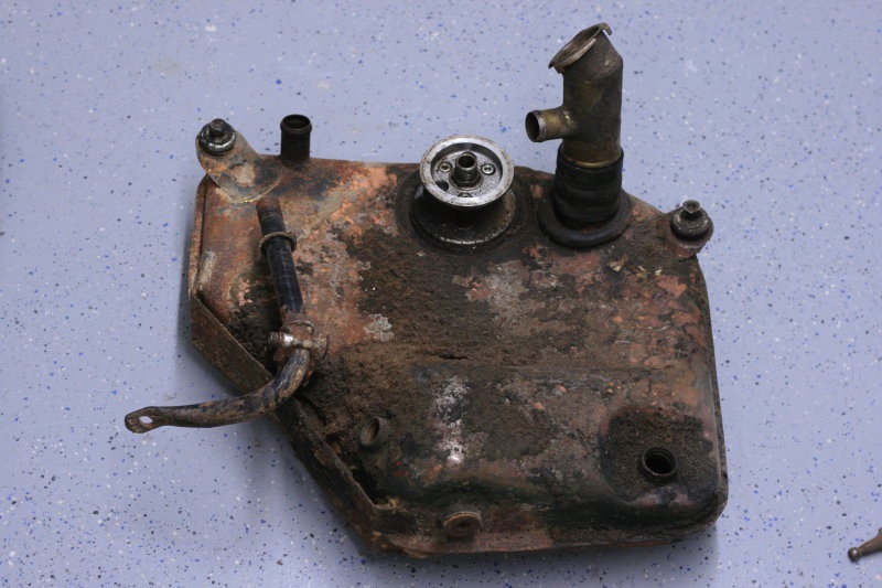

    Does anybody know what this is and where is goes? I thought is was an oil tank support, But I cannot figure how it would possibly fit.

    Head light wire conduit securing bracket SWB? I don`t have a picture handy to compare........ to your part from Facebook , below......cliff

    Thanks for posting the pic. I can never get this forum to post pics for me. Now I have a clue. Does anybody have a picture of the proper installation?

    The headlight tube mounting brackets are similar although I do believe you have an oil tank mount. part # 901.501.930.20
    It clamps around the bumper support tube and bolts to the tank.
    Here's a couple of pics stolen from google of the front mount and one on the tank

    I agree on the oil tank mount.

    Great! Thanks guys. I will soon be building a '67 from scratch so I will have lots lots of questions.
