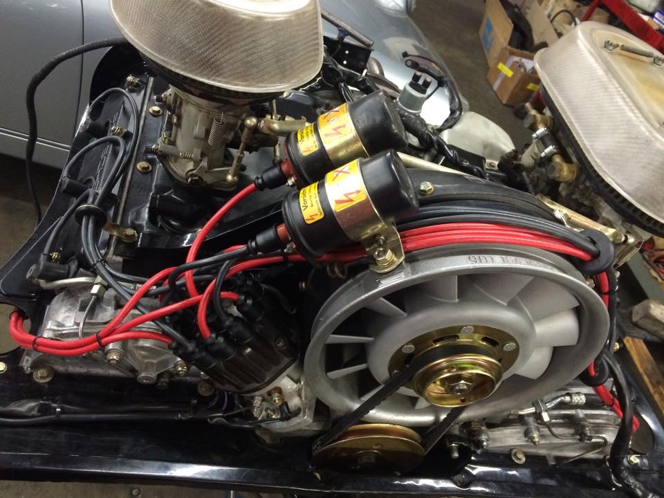

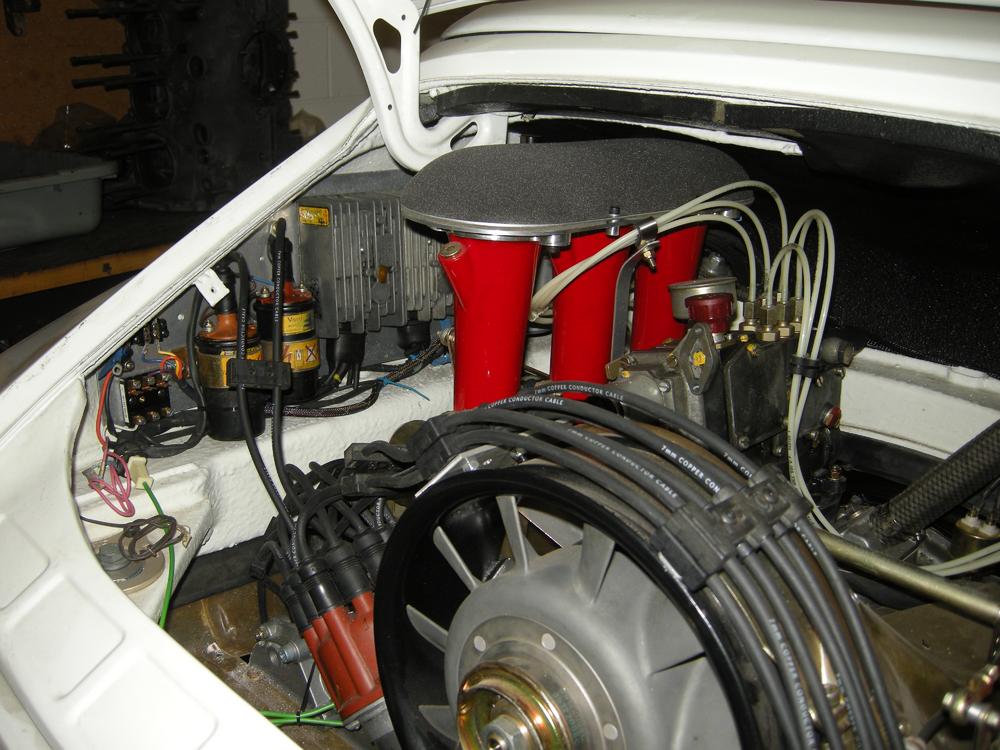

    I have carbs and the fuel pressure regulator and hoses block the lower, RSR, location for coils on the crosspiece.
    Can people show me their mounting pics for the bottom of the package shelf (I don't think the LH panel area will work for me).

    Here's one.

    Here's my preferred mounting location:
    Name:  TJ 2.7(2).jpg
    Name:  TLG 2.8 motor.jpg
    Name:  TLG 3.3L race motor.jpg
    -Marco
