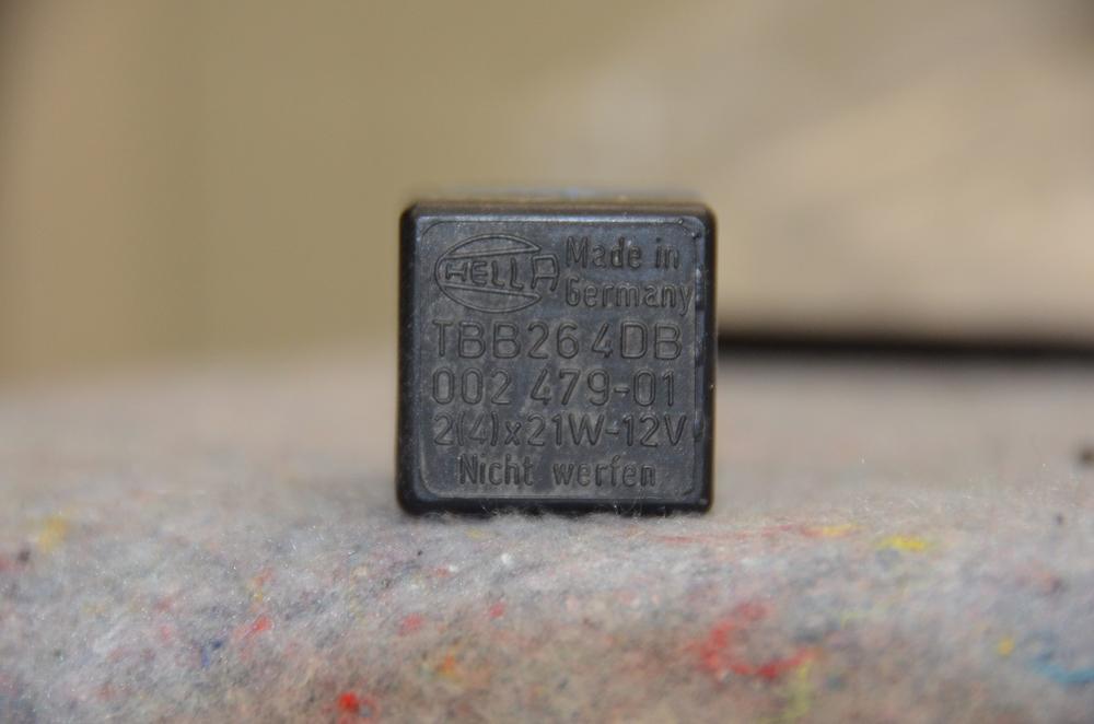

    What part number on the flasher relay, can you post a photo

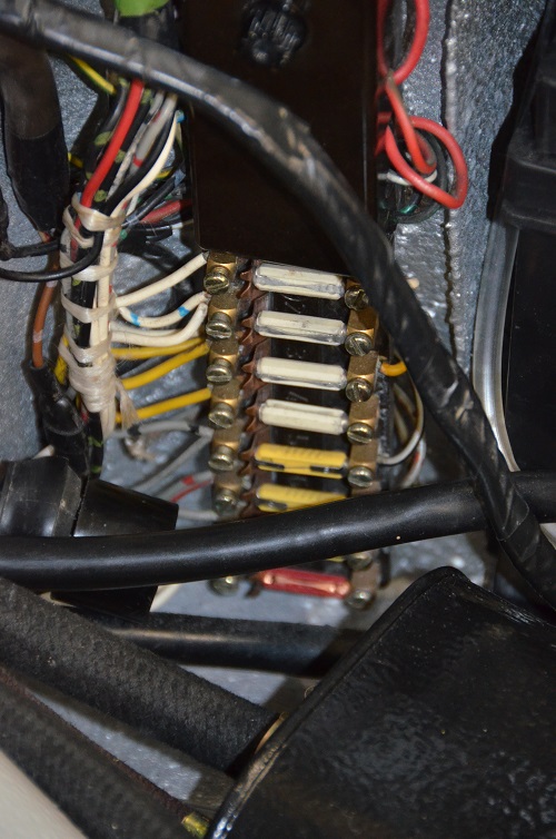

    Also photo of fuse box

    Here my homework photos that you asked for. Re the removal and reconnection of the lamp wiring, I did make a diagram of the location of where the wires were connected and hopefully re-installed them correctly - but in saying correctly - I mean as I found them so who knows. I plan to remove all the signal units and go through them again to eliminate any causes there. As to bulbs, I am using 1895 small bulbs at the corner markers which seem to operate just fine, and then 1073s where it calls for dual filament bulbs and 1034s for single. I am getting that information from the original owners manual, but did note that they call for front signal bulbs to be 1034s, but obviously incorrect as the bulb socket has two prongs for a double. All bulbs are new and I've tried several - either Phillips or Wagner but of course made now in China. Bulb tips have a small amount of dialectric grease. I did note that the 'C' terminal on the back of the flasher relay looks very dark compared to the others (should be evident in the photo), and such is the connection to the blue/white tracer wire that goes directly to a center location of the tach for the right/left indicators. Thank you for your interest and help. For $19.00 I have a new flasher relay from PORSCHE on its way.
