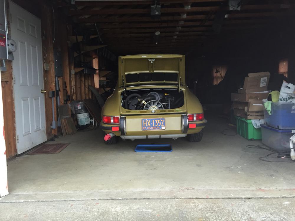

    Had my car corner balanced.
    It's within 50 lbs front back diagonal.
    Handles great and tracks straight.
    But it's about 3/8" lower on the left rear wheel arch.
    its noticeably off and looks odd from the rear.
    How are those values?
    Should I bring it back for tweaking?
    Or be happy with how it rides

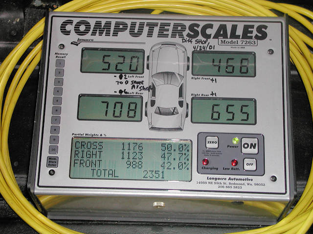

    This is a 912 corner balance.
    Name:  corner balance.jpg
    Here is a picture.

    Where's the battery?

    I guess the question I'm asking could this be made better?
    Standard dual batteries

    I think we both know that's not true. These cars were largely hand built and almost half a century later there are significant deviations from new. The individual corner weights, front and rear and cross weight will be helpful, can you post them up?
    All that said-- since you are using dual batteries, and it's unlikely that you have altered the static weight distribution in the car--- what suspension bushings, what sway bar in the rear? Could you have a sticking sway bar that is causing it to hang funny? The sway bars are disconnected when setting the balance (of course)-- and when reconnected if the preload is funny, or you don't have an adjustable drop link, could certainly cause what you are seeing.
