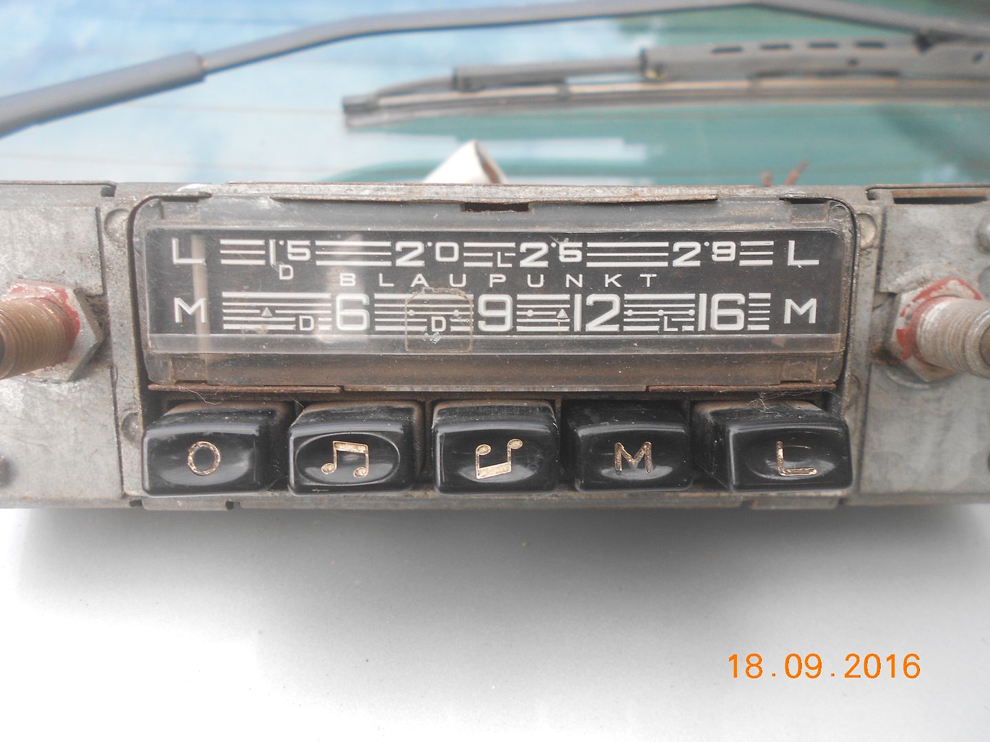

    Forgive me for saying this if you have tried it but my radio buttons were dreadful, could hardly see the white at all. I cleaned them carefully with a cotton bud and polish and lo and behold all the white was there - came up clean and bright. I was amazed.

    I am smiling as I write this. Here is the radio I cleaned. It is a 'W' Bremen.
    It was more dirty than this 'Y' Bremen.
    But look what happened when I cleaned the M button.
    So, if you are lucky it works, if you are not then get the marker pen!!
