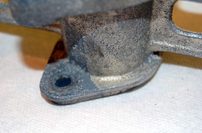

    Chris, do you see the lower casting, rightmost stack? See how there is a flat area above the head flange? That flat area was likely caused by the grinding wheel the factory used to flatten the top of the flange. It also creates space to swing a wrench (er, spanner) to tighten the nut.
    My original first-series sand cast Weber Manifolds had the same flat area-- they were first put in the plating solution, which I suspect was a ferric nitrate bright pickle, then the machining operation was performed, leaving the cut area dull gray, compared to the shiny silver of the rest of the manifold. This is another way I know it was a machining operation.
    Anyway, you might want to consider that when you set up the toolpath for final machining. Looking great by the way!

    Quote Originally Posted by 304065 View Post
    Very helpful, Thank you

    found an old photo
