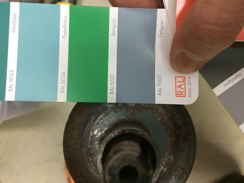

    Hi all-
    I'm responding to an old thread with hopes that someone may have an original paint strut and a color book.
    I have just a small spot of what I think is original paint on my '65 Boge strut - here are the two best matches I could find in RAL
    https://www.prismaticpowders.com/sho...-7000/ral-7000
    https://www.prismaticpowders.com/sho...-7031/ral-7031

    has there been any answer to the RAL tone?
    br
    haul

Size:  86.2 KB I used KRYLON, Gloss Smoke Gray
    Glenn
    I bought this from Moito. Color in thread very close to actual color. When Boges installed in '67S they were factory painted black. Same on '67 912 Targa. https://www.early911sregistry.org/fo...ght=BOGE+STRUT

    well, yes Franz should chime in, as close is close but not on point…
    @doigthom: you still have them and a ral card at hand?
    @gbone99: these look nice..
