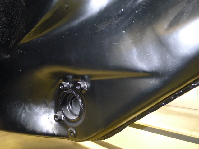

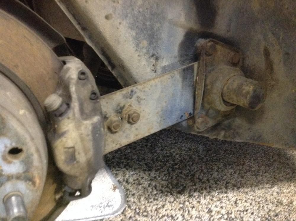

    Can anyone tell me how the heating tubes are going on these cars?
    Because I have tried to compare it with different kind of pictures but can't see it very well.
    Could it be that 303371 and 303381 have a different location of the heating tubes?
    This is car 303371. Can't see it very well

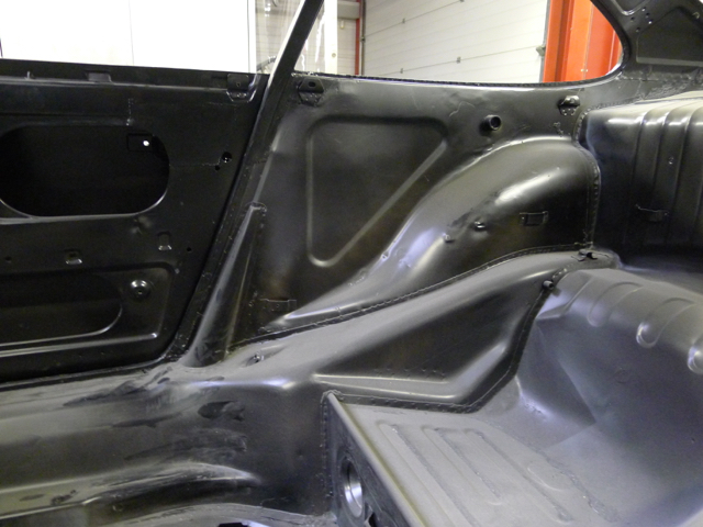

    This is car 303381. I suppose these are going above the torsion hole.

    the last pic is the above torsion tube type the other pics are hard to tell

    first of your pic is below type
    last pic looks like it already has been welded---so no good for reference
    also the 4 threaded sleeves are non mushroom type

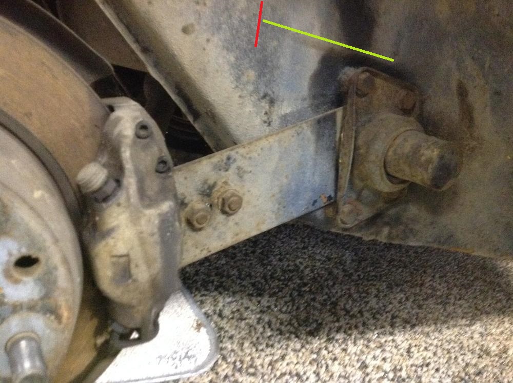

    What do you want to show with the yellow and the red line?
    303381 is mine car (with the above type)
    303371 is the car you showed in post #4. You are telling this is a below type.
    Is this possible that with only 9 cars in between these cars could have other type of heating tubes?
    Car 303371 has never been restored.
    So I am just thinking, could it be that my car 303381 have the wrong type of body panel? Or could the other heating tube type and so a other type of body panel could be correct for mine?

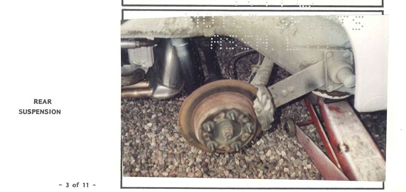

    Here you can see a picture of my car made for the FIA rally paperwork.
    You needed to take pictures from different parts to post with the paperwork.
    Don't know if you can see if this the same as with the picture I showed you in post #1?
    this pic shows below type and someone messing up the body with a jack
    This means that my car has the wrong rear wheel arch panel mounted at this moment?
    We received it like this (such as posted in post #1).
    Thought this almost was never replaced with a car...
    Is there a way that I can check if this has been replaced?
    Are there factory replacement parts by Porsche that has the correct below type or are they always the above type?
    Moito,
    Here are 3 pictures of my car.
    Don't know if you (with your experience) can see if these every has been replace?
    My experience is not so good.
    Below two pictures from exterior and one picture from interior
    Senior Member moito's Avatar
    May 2013
    AUSTRIA (tu felix)
    6,715
    definetly some welding job done on the "black" car
    drill a hole or buy a endoscope and have a glimpse how the tube runs
