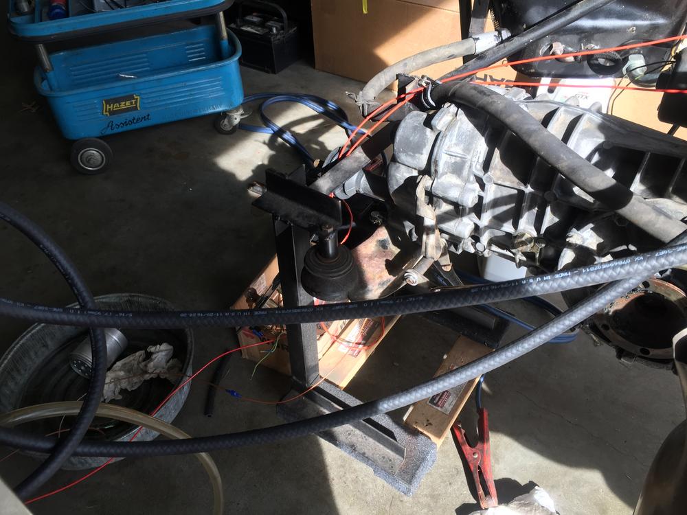

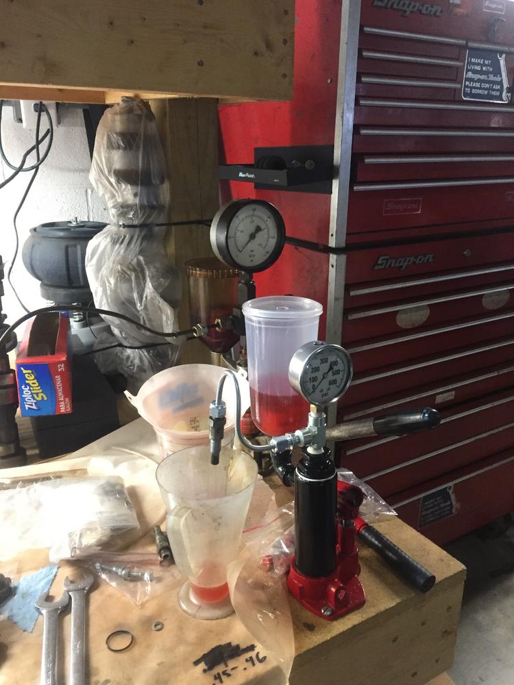

    Have an oil leak on the engine and planned to remove and tear down to fix. Decided to run it out of chassis. One of my Porsche friends had this built for his 67 engine. Bought the injector tester that is in the foreground from Mercedes Source. Works on MFI injectors as well as tii injectors.

    would love to see more photos of the run-in stand

    Will get some additional shots today.
    Close to getting ready to fire her up

    Ran the engine for a few minutes but new oil line to injection pump leaked, another line on its way. Will give it another shot when the new line gets here. Been interesting.
