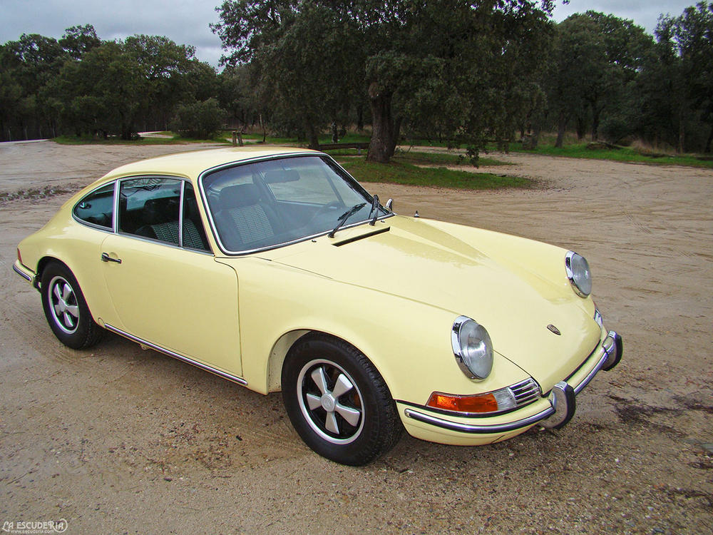

    i see some cars with the body color in those places...theres the doubt...
    check this one

    Pmc007, If wheel wells are left body color on those 2.2l, beleive me its not factory spec.
    The guy who sprayed the car did not know how to do it right. Yes its often seen and its often done wrong.
    If you have Brian Longs book which only shows period photos, you ll see no wheel well on any 2.0 or 2.2 is body colored, same goes for engine bay.
    Btw if you want to go period correct, the undercarriage on that above car is wrong too, it should have matt black stone guard and an additional black stripe of paint up towards the T door trim, plus probably, the black paint on door edges behind door trim is missing too..Door handles look 1969 2.0l, not 1970 2.2l and black seat hinges might pinpoint seats are from a later 2.4l model.
