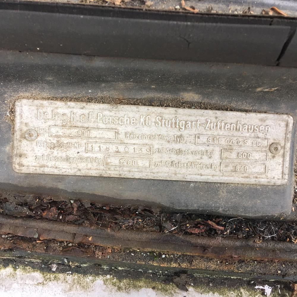

    We are trying to figure out exactly what this car is. I have a photo of the VIN tag. Some sites I look at say 911 s and some say 911 L.
    Any help?

    basic 911 Coupe US, not a T, L, S or R, just a 911

    Not a 911L. If I recall correctly, the VIN series for the US '68 911L coupe is 11805001-11805499. Just checked my books, and Davey is spot on: 11830139 is a 911 coupe (one of 473 made in 1968)

    That Heizeinrichtung Typ number with the S in it is for the heater type. http://www.early911sregistry.org/for...6-on-VIN-plate

    Just a base 911 coupe.
